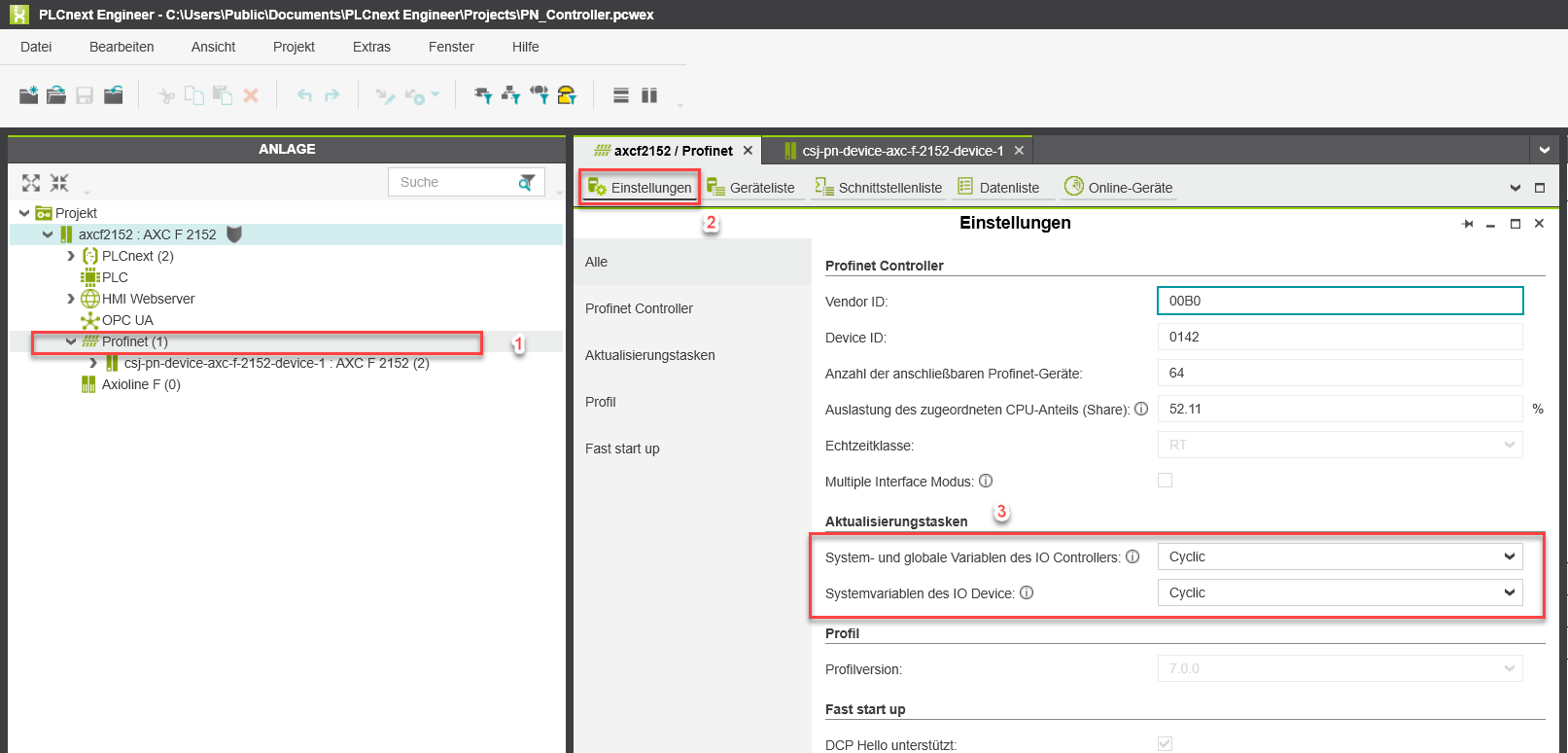

the DataLogger Service logs the values of variarbles into SQLite DB, it is  not possible to log the complete arrays or structure.  The simplest way is to create/declare the log varaibles of needed types and assign the received and converted PN-Data to this variables. Please note, the PN-update rate should be synchronized with the task cyclic (executes the program which assign the values) Of course, the PN-update rate should be also equal to task cyclic.
PN Settings
