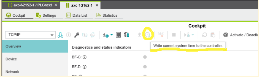

  1. In Cockpit (update the PLC real time clock with the PC clock):
    Cockpit

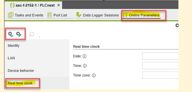

  2. In Online Parameters:
    OnlineParameters

when using your step 1 (in cockpit), the controller does not accept the time from the PC. I have been updating the RTC in the online parameters.

I can't reproduce the behavoir with the setting the RTC-Clock in Cockpit with the time from the PC, please see the attached video (I'm using the FW2020.6.1 and PLCnEng 2020.6 ).
