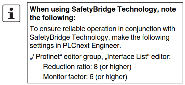

Hi, What about Safety-bridge? We are recommended to use 2019.3 firmware?
# g.br 2019-09-13 12:16
Thanks for reminding us of that, just added a hint for SBT users!
