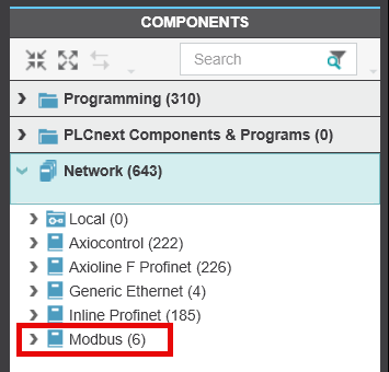

      ↪ The Modbus library is copied into your PLCnext Engineer project.
      ↪ A Modbus node becomes visible in the Network section of the COMPONENTS panel:

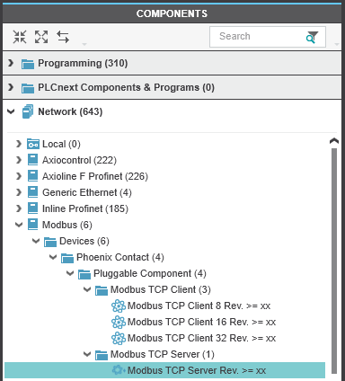

  • To assign the Modbus TCP Server feature to your device, unfold the Modbus → Devices folder stack down to the Modbus TCP Server items:

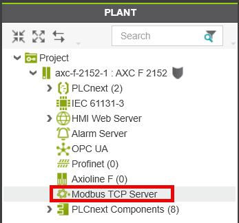

  • Click and drag the appropriate Modbus TCP Server item from the right-side COMPONENTS panel over to the left-side PLANT panel and drop it onto the controller.
    ↪ A Modbus TCP Server node becomes visible:

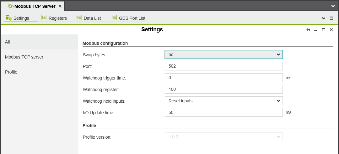

  • Double-click the Modbus TCP Server node in the PLANT panel to open the Settings tab in the working area.
You can specify in the Settings whether data swapping is required, which port should be used by the server, the watchdog and the update cycle time. Make sure to add the configured port (default is 502) to the rules in your firewall configuration.
