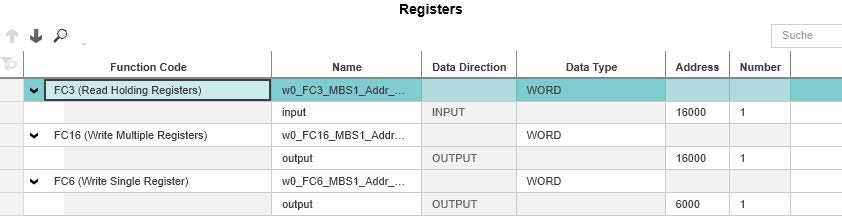

  • Switch to the Registers tab to set up the Modbus function codes (FC) and data types for your application, e.g.:
    ↪ The function codes are then connected to global variables which you can are also see listed at the bottom of the Data List tab as Process data items.
Once you have set up function codes in the above Registers tab, then you can work with these global variables in your automation programs.
