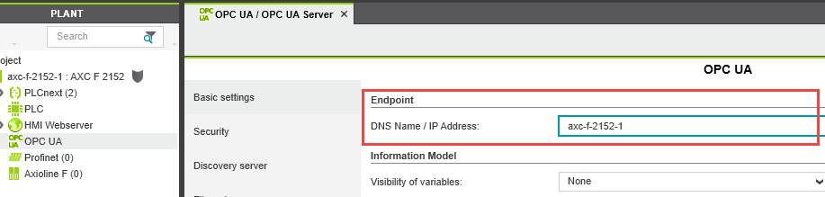

The eUA server offers an endpoint to which the clients can connect. In its URL, you can either configure the IP address of the controller or the DNS name. Implement the configuration in the PLCnext Engineer software:
  • In PLCnext Engineer, open the OPC UA node in the PLANT area.
  • In the Basic settings, enter either the DNS name or the IP address in the input field.
More information on configuring the host name can be found in the PLCnext Engineer Online Help. It can be found within the software under  HelpView Help menu, or online (from software release 2022.0 LTS).
