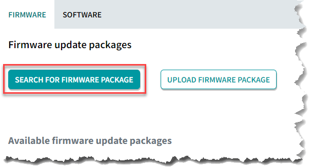

  • To search for available firmware packages, click the SEARCH FOR FIRMWARE PACKAGE button.

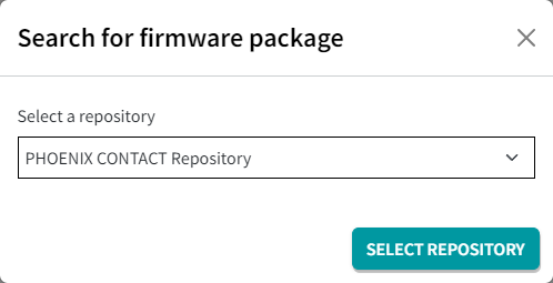

  •  Select a repository from the drop-down list and click the SELECT REPOSITORY button.

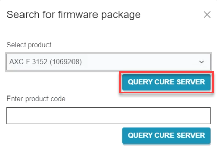

  • Select one of the proposed products or enter the item number or the article description of the product for which you want to search for updates (e. g. the PLCnext Control AXC F 2152).
  • Click the QUERY CURE SERVER button.

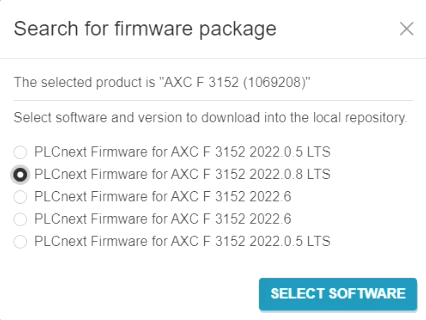

  • Select the firmware package you want to download into your repository and click the QUERY CURE SERVER button.
  • Click the SELECT SOFTWARE button.

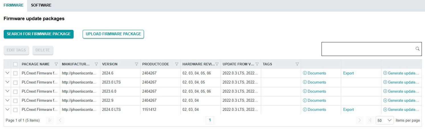

The selected firmware (to be exact: the description files of the firmware) is added to your available firmware update packages list.

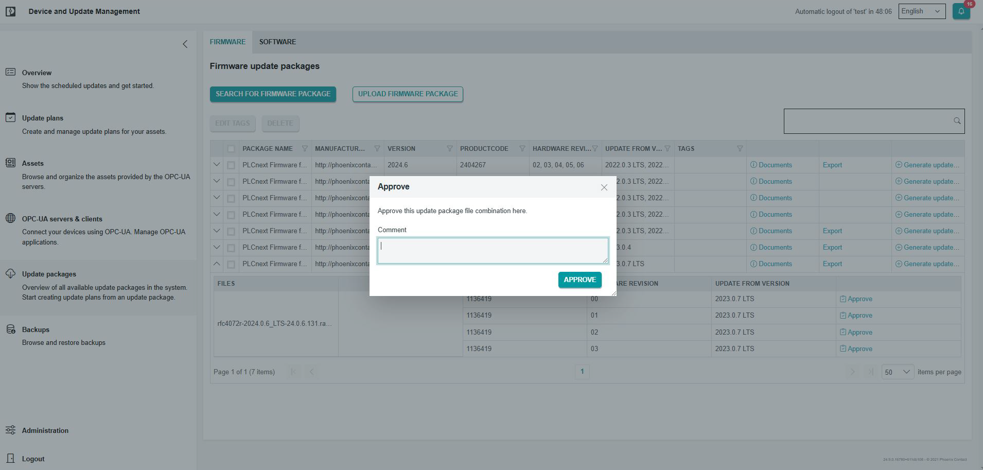

Each firmware update package has to be approved before downloading. To approve a firmware update package, proceed as follows:
Note: To approve an firmware update package, you need the appropriate user rights.
  • Click on the update package you just added.
The approval window opens.
  • Enter a comment and click the APPROVE button.
