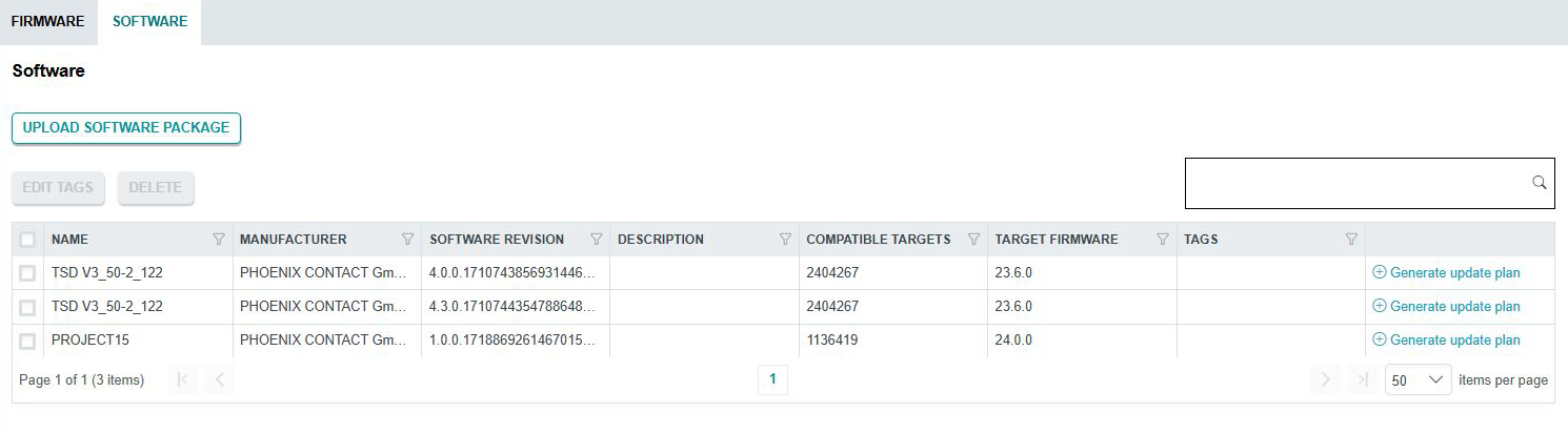

Upload the exported *.zip file in the Device and Update Management. Proceed as follows:

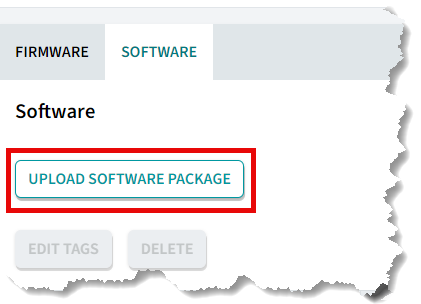

  • On the update packages page, open the SOFTWARE tab and click the UPLOAD SOFTWARE PACKAGE button.
A new window opens.
  • Select the update package file and click the UPLOAD button.
The selected software (to be exact: the description files of the software) is added to your software packages list.
