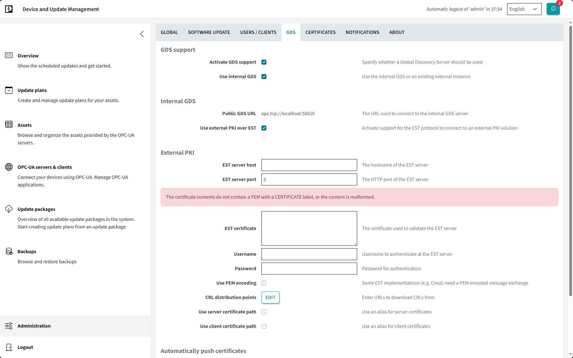

On the GDS tab you make all settings around the GDS (Global Discovery Server).

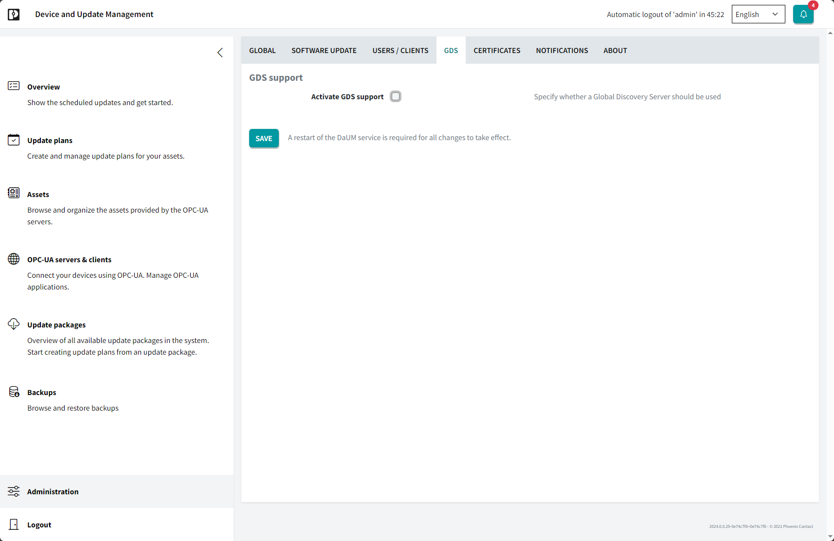

GDS support
In the GDS support area you specify whether you want to use a GDS or not. You also specify whether you want to use the internal GDS or an external GDS.
External GDS
If you use the external GDS, you must enter the corresponding address in the External GDS area.
Internal GDS
If another client is to be connected to your GDS, you must specify the URL in the Internal GDS area.
If you want to use a PKI as the certification authority that distributes certificates to the devices via EST, you must enter additional information about the PKI.
Automatically push certificates
You can push certificates automatically by scheduling a regular push.
