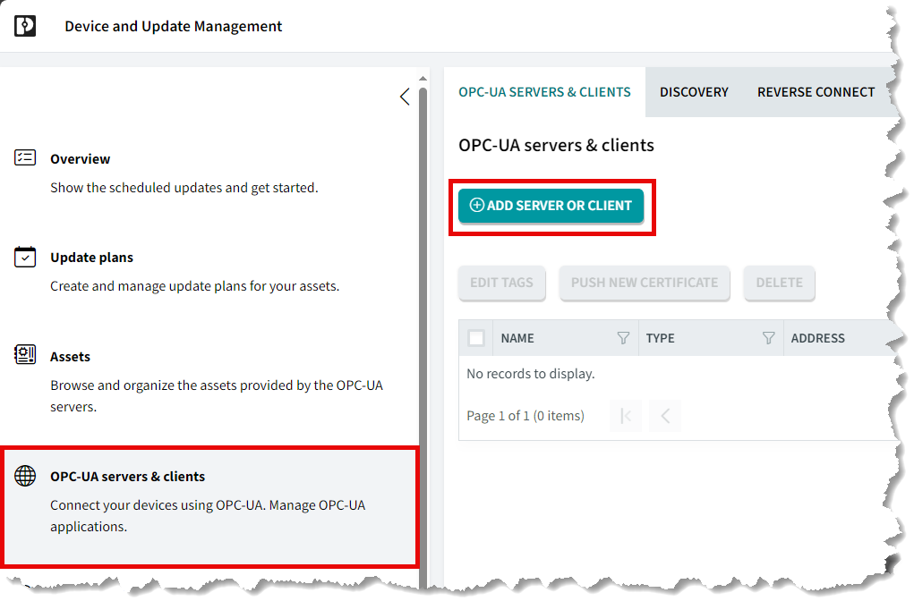

If you create a connection via + ADD SERVER OR CLIENT, then it is directly in the GDS and the specified devices are directly known to the GDS.

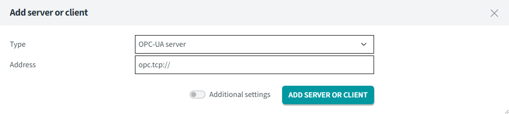

  • To register an application, click the + ADD SERVER OR CLIENT button.
The Add server or client dialog opens.

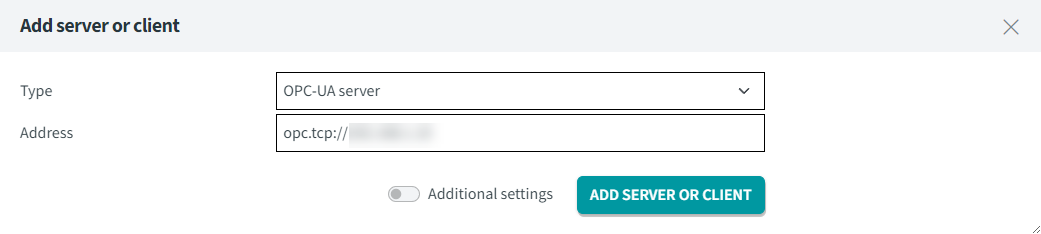

  • Chose the type and enter the IP address or name and the URI.
  • Click the ADD SERVER OR CLIENT button.

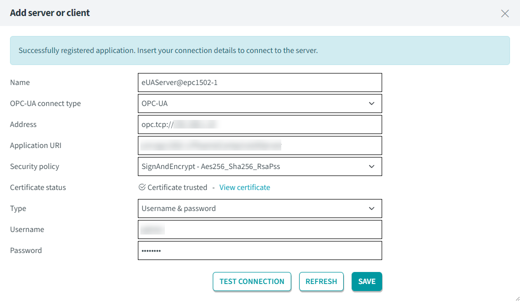

You successfully registered the application. Now connect to the server.
  • To connect with the GDS, enter the username and the password that you use to log in to the asset via the WBM.
  • Click the SAVE button.
The connection has been created.
