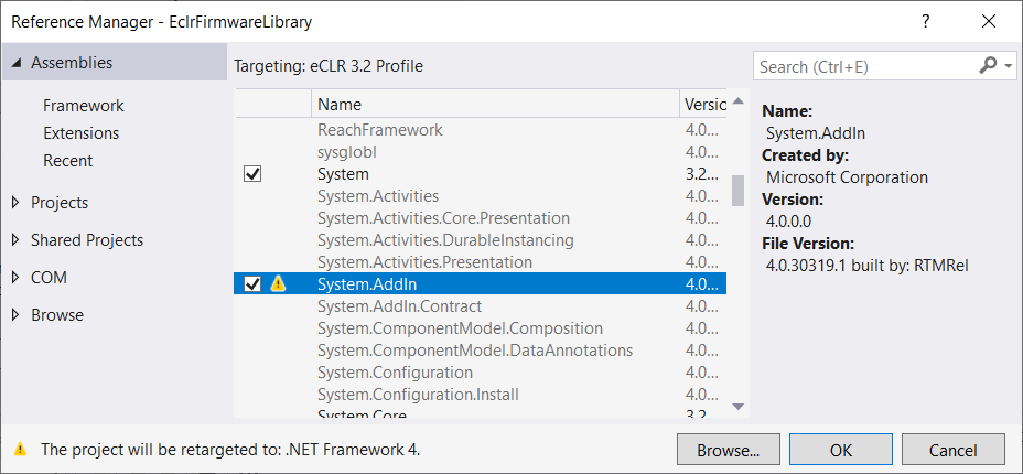

  3. Check for troubling libraries
    Referencing one of the libraries created by Microsoft Corporation (they're slightly grayed out in the list) will retarget the project to .NET framework 4.0, so it is not running on PLCnext devices anymore (regard the warning sign):
    target .Net 4.0 library
    You have to change it back in the project settings and delete the reference in order to work with PLCnext Technology.
