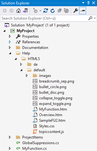

The bunch of files that make up the HTML page will be added to the project in the directory Help/HTML5/<culture>.

For each function or function block you will need a separate .htm file with the namespace and name of your function or function block in the following format: <namespace>.<name>.htm. You can copy an existing .htm file, rename it accordingly and translate the content to meet the target culture.
Once you have a set of files prepared for another culture, add them as described above, providing the culture. That Help/HTML5/<culture> folder will be created.
