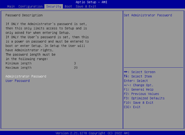

Several options in the BIOS can help to protect the system.
The BIOS configuration can be contactor protected by using a password.
In the "Security" area, it is possible to define an administrator and a user password and thus deny unauthorized persons complete or limited access to BIOS configurations by using the "User" profile.
By default, the password requirements are set to a minimum of three characters, but passwords should always contain at least eight characters.

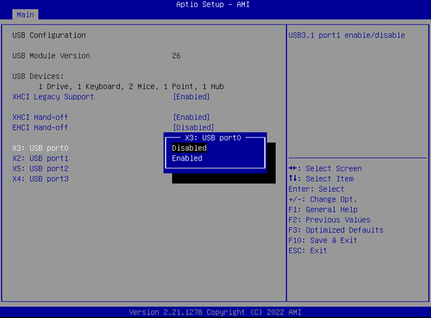

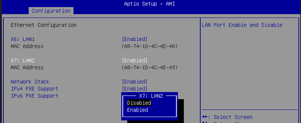

Deactivating unused interfaces
Deactivating the interfaces and ports that are not required increases external access protection immensely.
All interfaces and ports can be deactivated in the "Main" area of the BIOS configuration.

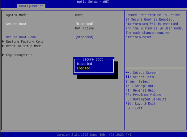

Secure Boot activation
Activating the secure boot function provides contactor protection against hardware manipulation. Each boot process checks that no unwanted adjustments have been made to the hardware and its firmware components.
Secure Boot can be activated under the "Configuration" tab.

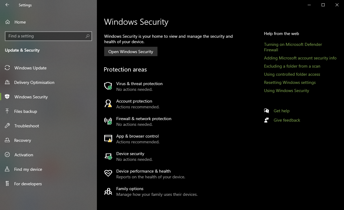

Windows® security
In Windows®, there is the menu item "Windows® security" in the settings under "Update & security". All relevant operating system security options are listed here and their status is displayed.
Here you can see whether you need to adjust or change security functions.
