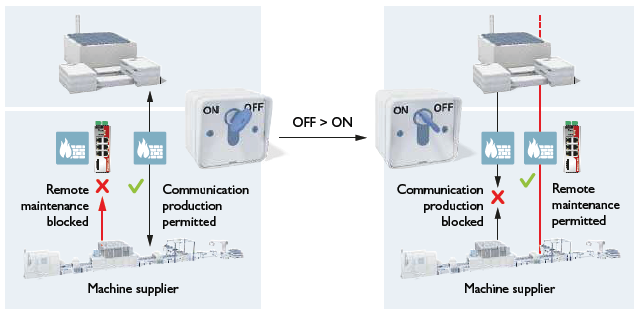

- Installation of a key switch on the machine to initiate or inhibit remote access. The figure below shows an example.
A key switch ensures that only intended changes can be made to the machine. At the same time, the key switch also enables the communication rules in the network to be blocked while remote maintenance is being carried out. - Secure passwords for all access ways to ICS devices. This should also include access from mobile end devices via WLAN.
