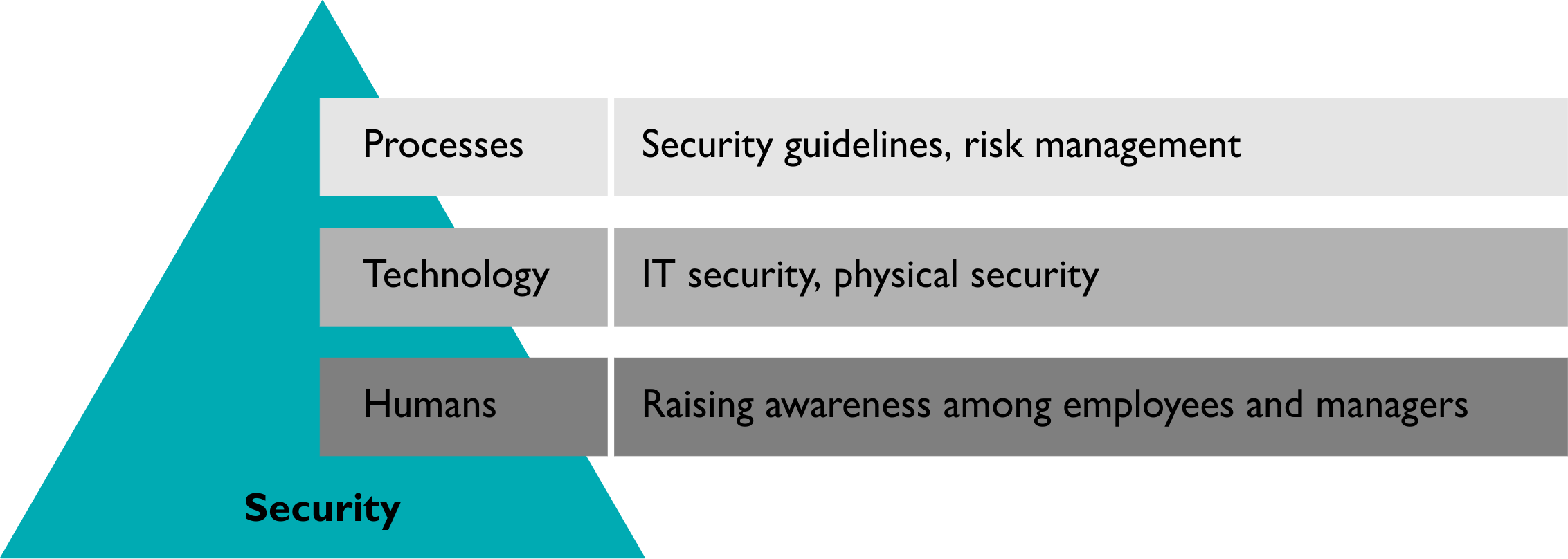

Dimensions for a holistic protection
Security can only result, if all of the following three dimensions are considered in a sufficient way. Organizational and technical measures must be defined, implemented and applied/followed.
The figure below illustrates the dimensions of the holistic security measures and the following table explains details.
Dimension Offsite consideration (not ICS-specific) Onsite consideration (specific ICS in operation)
Process
  • How were the system components (devices used to build automation infrastructures and systems) involved developed?
  • Which security-related capabilities does the system integrator have? (Policies, procedures, competence of personnel, etc., regarding design, implementation, commissioning, maintenance.)
  • Which policies and procedures does the system integrator follow during the plant design?
  • Do the plant operation processes fulfill the security requirements regarding policies, procedures etc.?
Do the policies and procedures consider and include the necessary security-related aspect regarding the
  • design
  • operation
  • maintenance
of the plant?
Technology
  • Which security-related features are provided by the components used?
  • What is implemented in the plant?
  • Which protection functions (functional security capabilities) are implemented in the plant?
    (Based on the requirements of the IEC 62443-3-3.)
People
  • How does the system integrator personnel follow the security-related policies and procedures?
  • How is the life cycle of each component realized by the product supplier? Consider all aspects from specification to development, test, patch management, technical support, etc.
  • How are the operating personnel instructed, trained and guided with regard to secure plant operation?
  • How strictly does the plant designers follow the security-related policies and procedures?
  • How strictly does the plant operators and maintainers follow the security-related policies and procedures?
