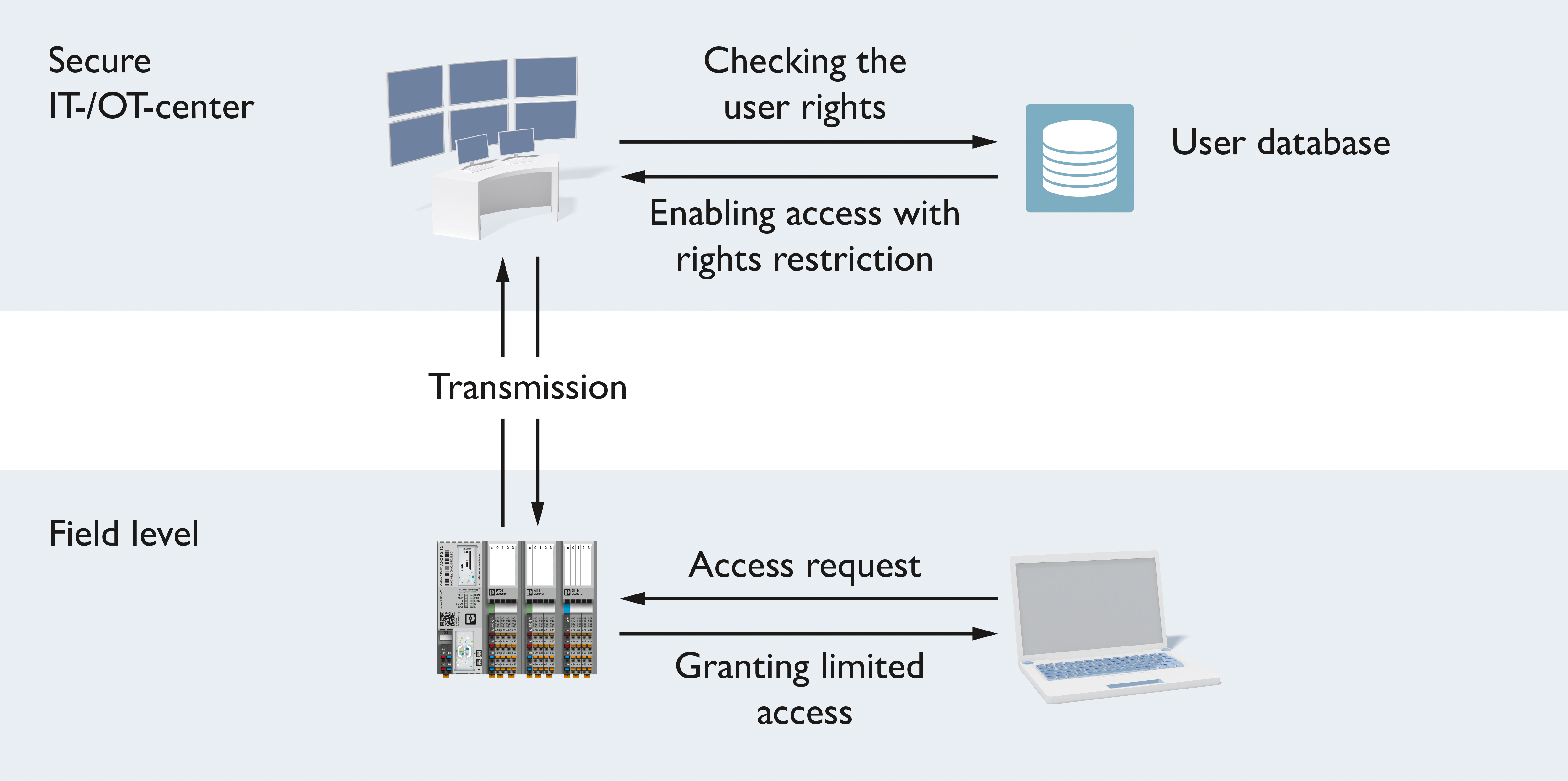

User management can be done locally, but is then difficult to administer. Central user management systems, as shown in the example below, are more practical
Note: If a system does not support access control, a dedicated firewall can help by permitting predefined connections only if the user has previously logged on to the firewall.

Why using a central user account management?
This question can already be answered by one simple example: In ICS networks, group passwords are often used for user access. The collective password is therefore known to many users. However, when employees leave the company, passwords are not changed or access is not blocked and can be abused. To solve such problems, a central user management should be used in which individual access rights are assigned to each employee.
The IEC 62443 standard (part 4.2) requires that the components involved in an ICS should "provide the capability to support the management of all accounts". This means it should either provide the management of all accounts directly according to part 3-3 or should be able integrate into a higher-level user account management system.
Integration into a higher-level user management means that the evaluation of the user authentication is performed in the higher-level user management system but not in the component itself. Many Phoenix Contact devices support this integration.
For such remote authentication, special network protocols are available which are referred to as "dial-in user services". Examples are RADIUS or LDAP both of which are briefly described below.
