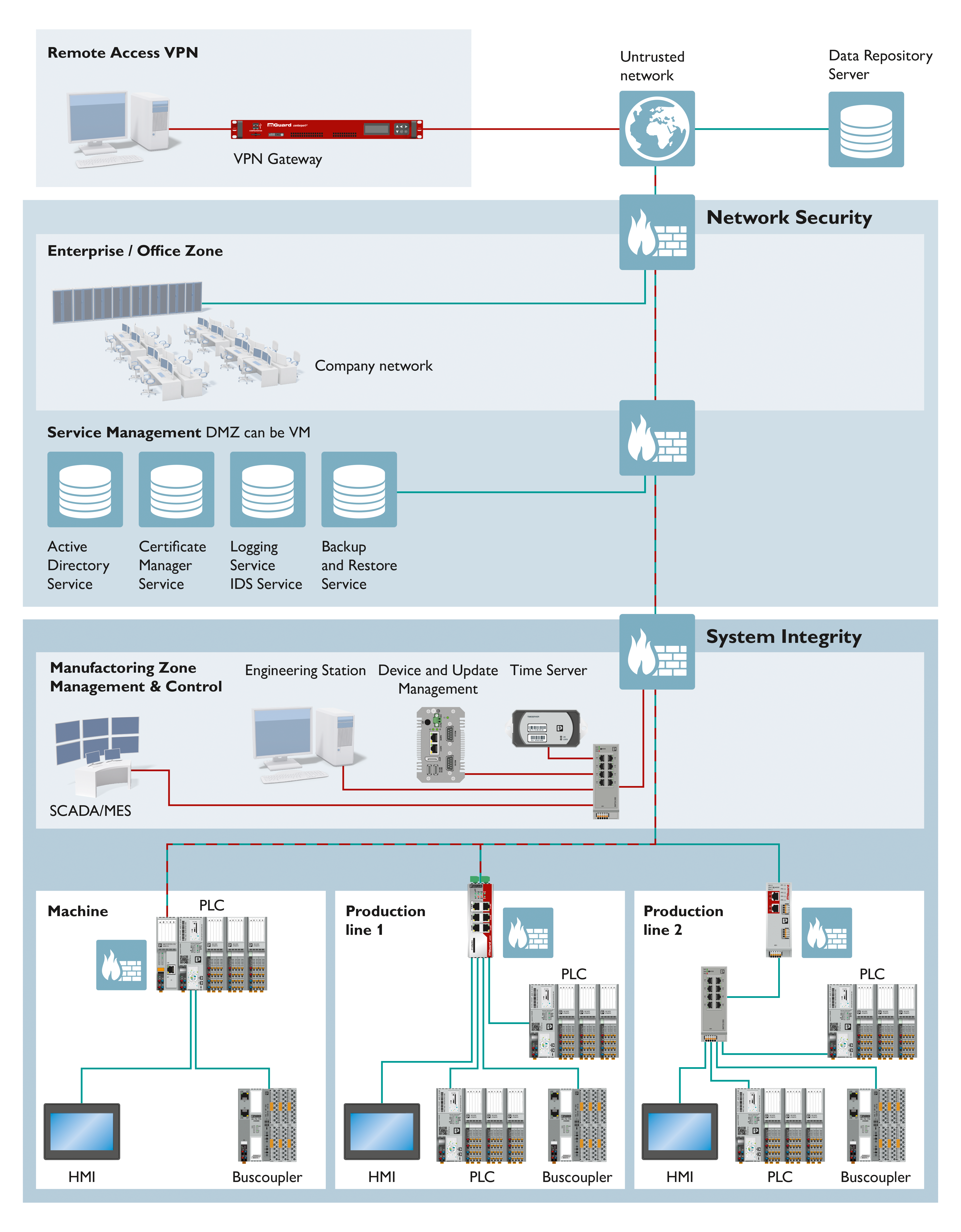

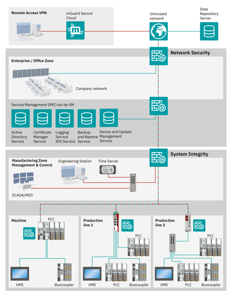

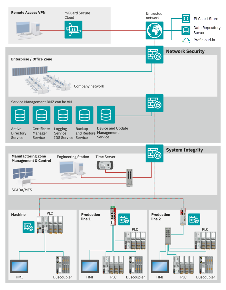

  1. Openness is the leading approach, security is not a leading requirement:
  2. Security is an overall system design requirement, and is ensued by the system design:
    • WBM offers support by User Management, Certificate Authority, Firewall, Syslog, etc.
    • No security certification of the device is provided.
  3. A PLCnext Technology device is an IEC 62443-4-1/4-2 certified component:
    • Security Profile must be activated.
    • Security context described in this PLCnext Technology ‑ Security Info Center must fit the required automation system use cases.
    • IEC 62443-3-3 and IEC 62443-2-4 system design and installation/maintenance processes are supported.
    • Centralized security functions like Device and Update Management (DaUM), logging, backup and restore or OT PKI might be combined on an Edge Device and moved from the Service Management zone (IT) to the Manufactoring zone (OT) to separate IT and OT more strictly.
