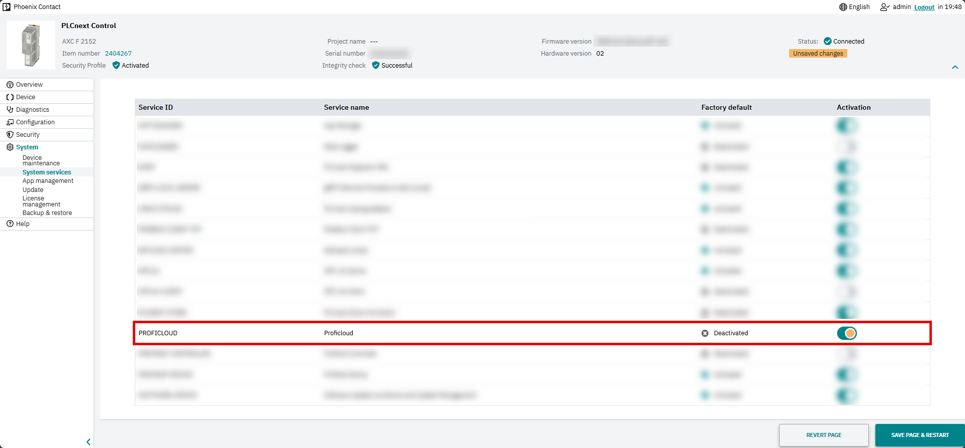

The Proficloud is deactivated by default. To activate Proficloud, proceed as follows:
  • Log in to the WBM.

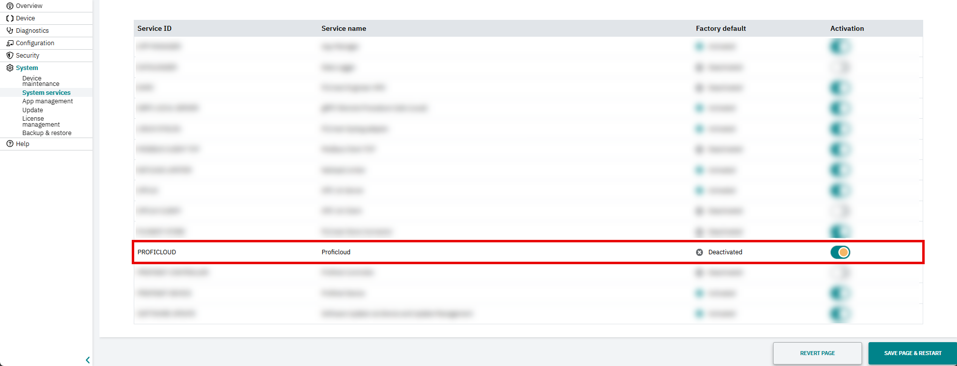

  • Open the System services page (System → System services) in the WBM.
  • Activate the toggle switch of the Proficloud .
  • Click the SAVE PAGE & RESTART button.
After a reboot, the Proficloud page is available.

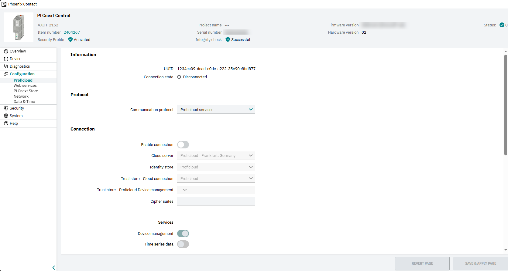

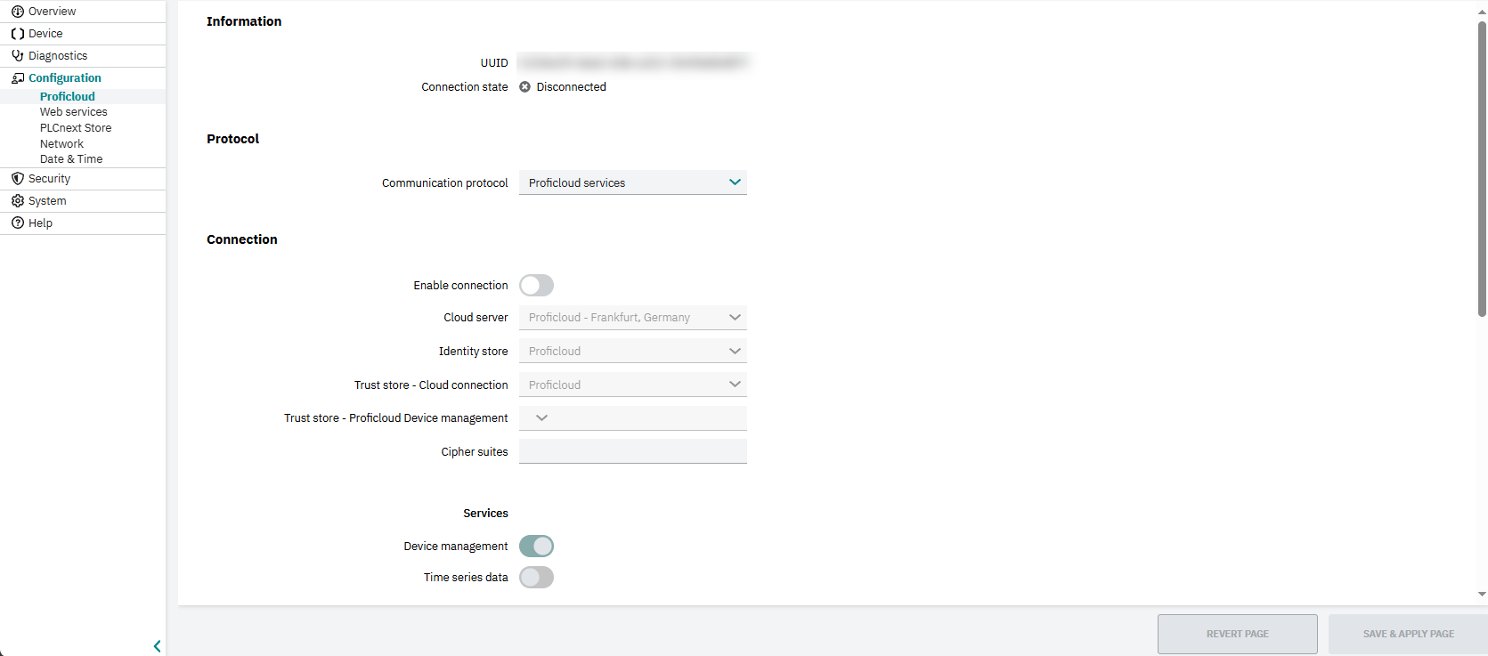

After the risk and threat analysis, configure the Proficloud as described in the main PLCnext Technology  ‑ Info Center.
