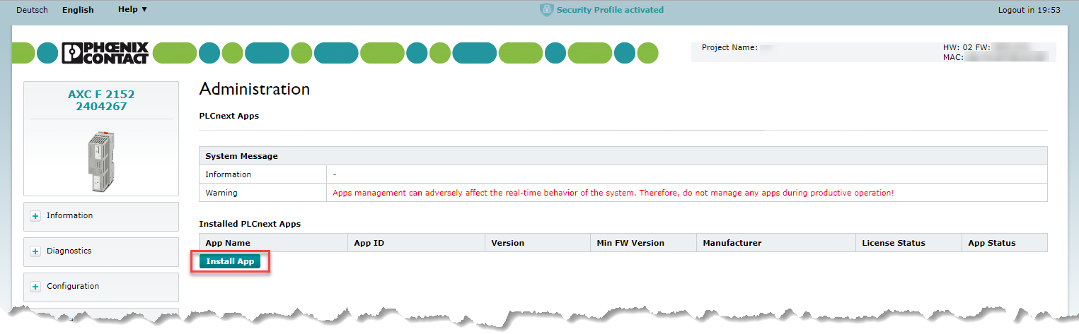

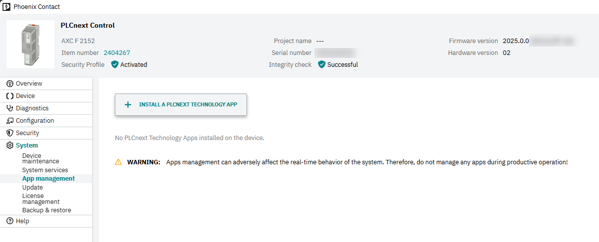

To install apps, you must have admin rights. Otherwise, it is not possible to check and adjust the configurations in the WBM that may have been changed by the app due to the lack of access to the App Manager.

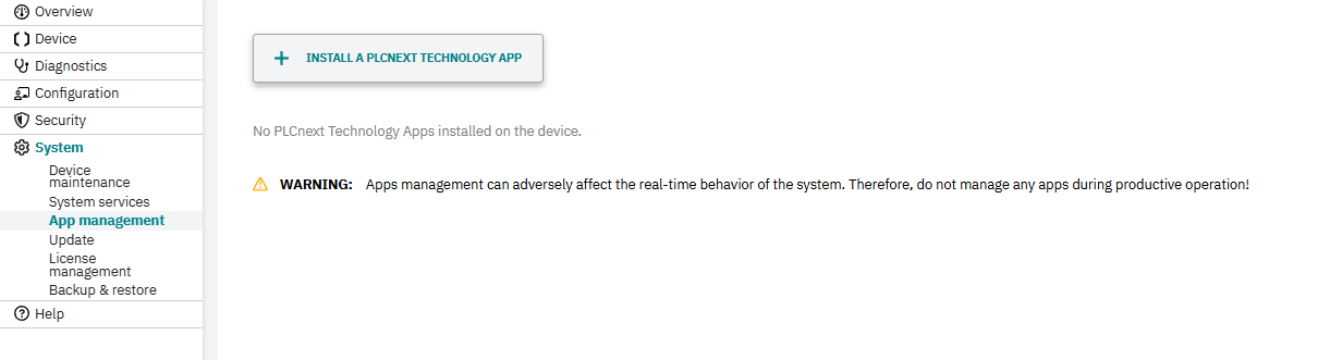

To install and license apps from the PLCnext Store, the App Manager must be activated. The App Manager is activated by default.
You install apps on the App management page (System → App management) in the WBM.

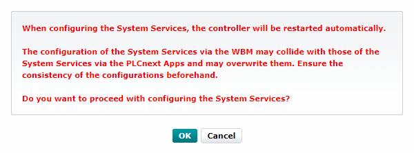

  • After app installation, check the System Services settings.
    Apps can activate or deactivate System Services during installation. For example, when you launch container apps, the controller automatically reboots. This causes the App Manger to be deactivated if a Security Profile is active. You must re-activate the App Manger to check the installed apps or to install additional apps.
