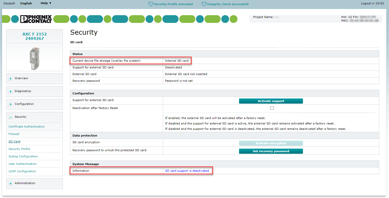

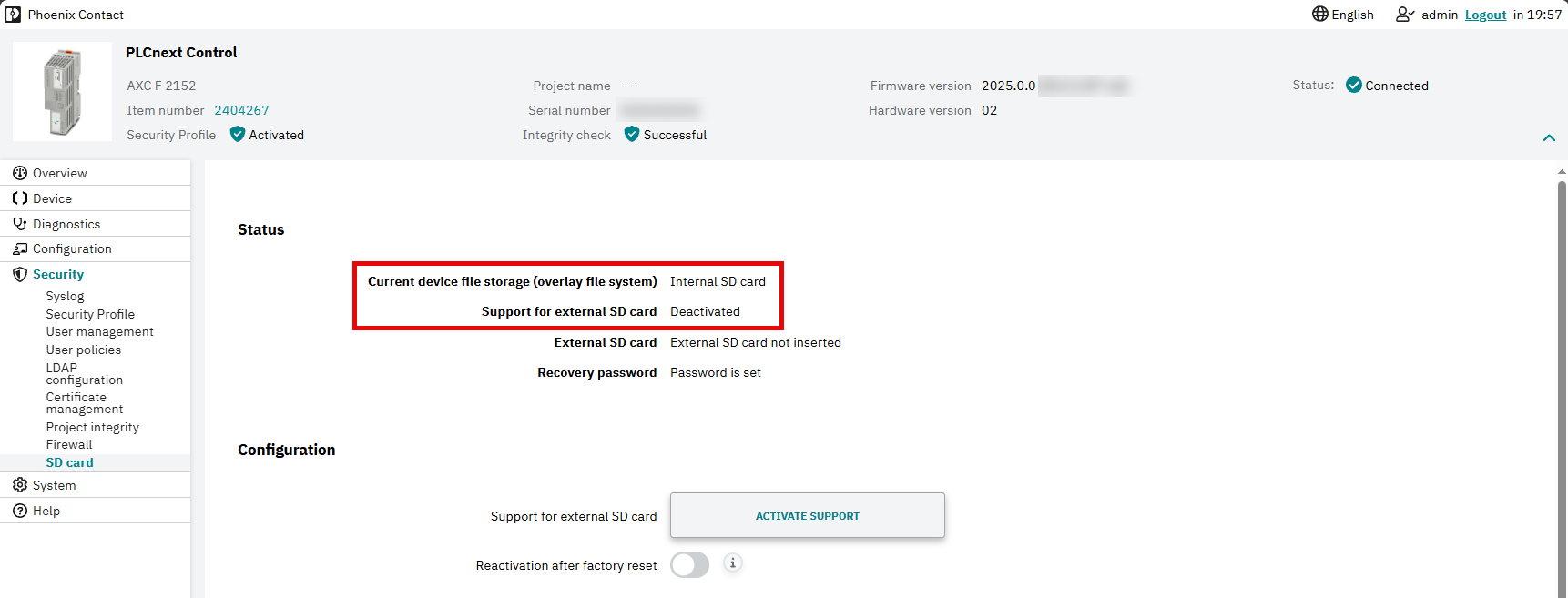

Checking SD card settings
- Log in to the WBM.
- Open a web browser on your computer.
- In the address field, enter the URL https://<IP-address-of-the-controller>/wbm,
To ensure that the default security profile settings are applied, proceed as follows:
- Open the Security → SD Card page in the WBM.
- Make sure that only the internal SD card is used to store device files.
- Make sure that the external SD card support is deactivated.
For more information on SD card settings, refer to the SD card settings topic in the main PLCnext Info Center.
