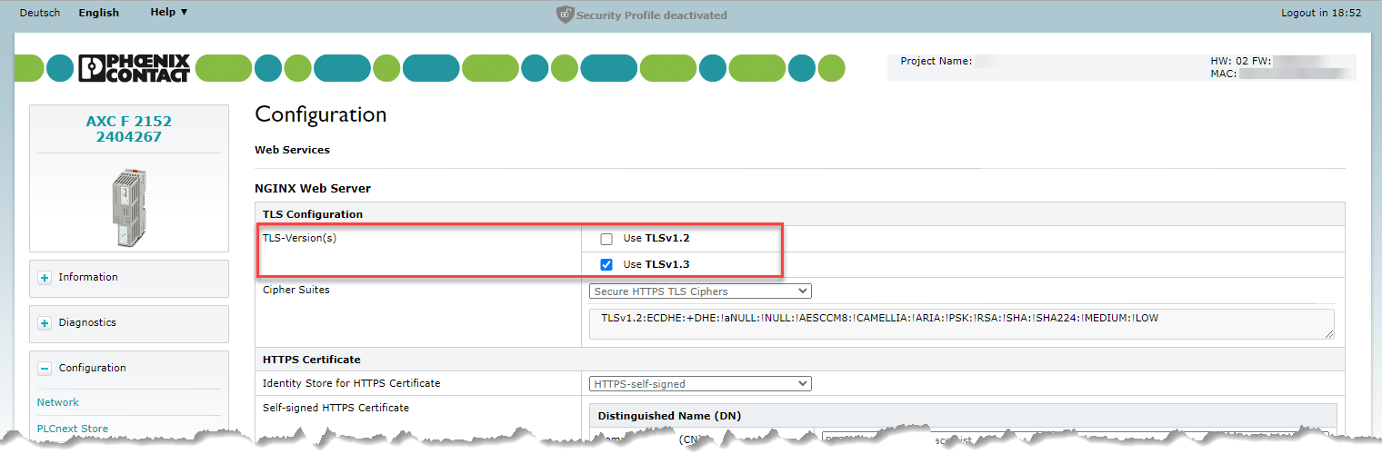

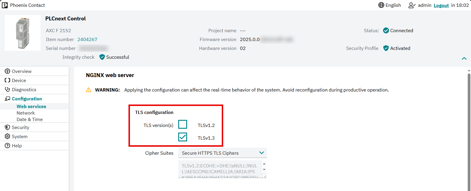

  • Log in to the WBM.
  • Open the Web Services page (Configuration → Web Services).
  • Select TLS version TLSv1.3.
Note:
  • If you cannot set TLS version TLSv1.3, set TLS Version TLSv1.2.
  • If you set TLS Version TLSv1.2, you must set Secure HTTPS TLS Cipherscipher suite.
  • If your browser does not support the secure cipher suite, you must set the Default HTTPS TLS Ciphers cipher suite. In this case, you must perform a risk and threat analysis.
