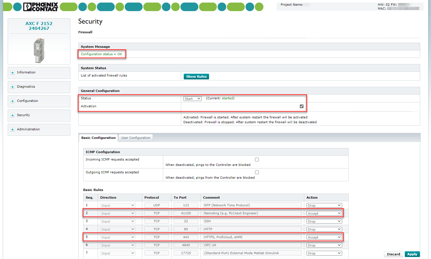

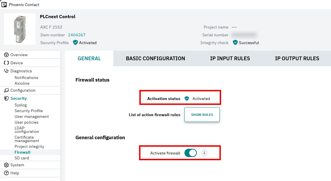

  • Log in to the WBM.
  • Open the Firewall page (Security → Firewall) in the WBM.
  • On the GENERAL tab, check in the Firewall status section whether the activation status is "activated" and in the General configuration section whether the checkbox Active firewall is activated.

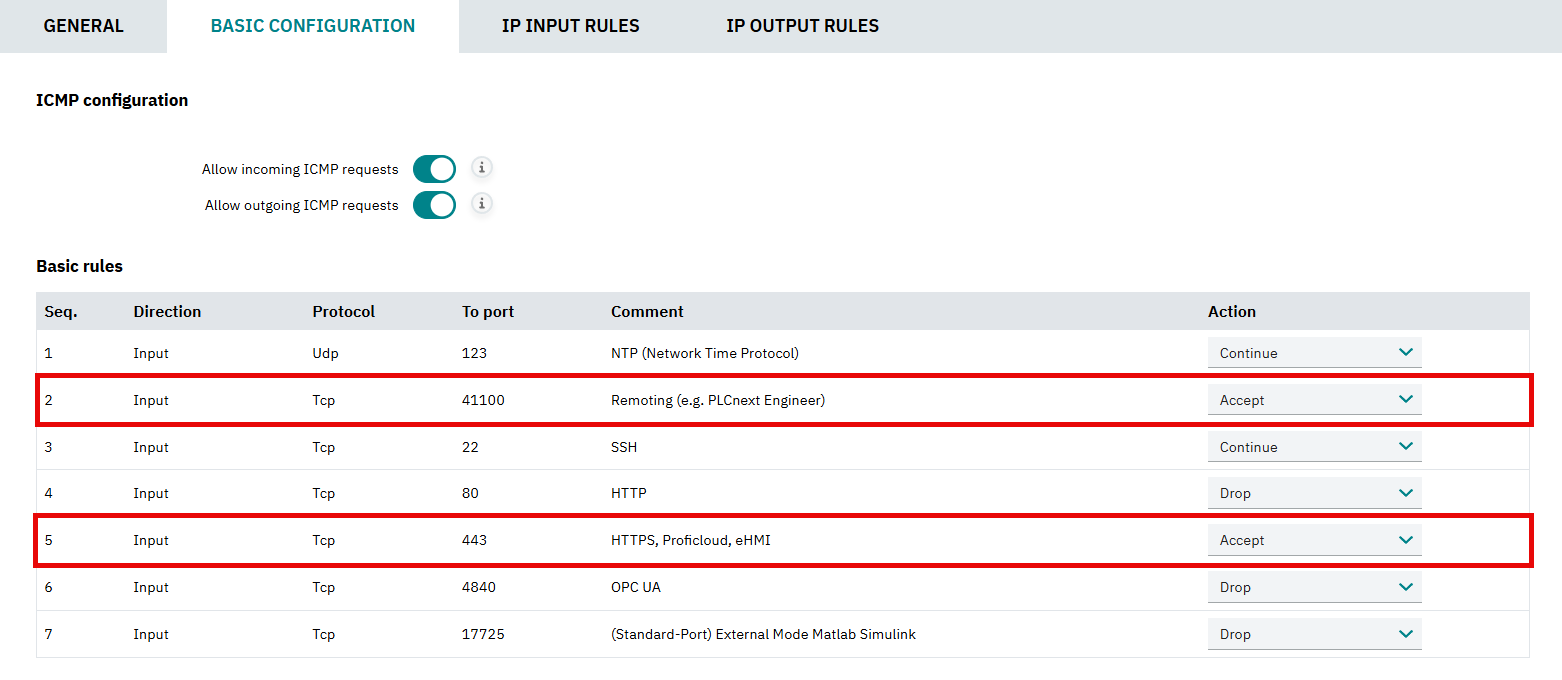

  • Check on the BASIC CONFIGURATION tab whether only the following incoming connections are enabled:
    Description Protocol Port
    Common remoting, e.g., using PLCnext Engineer TCP Port 41100
    HTTPS, web server for eHMI and WBM TCP Port 443

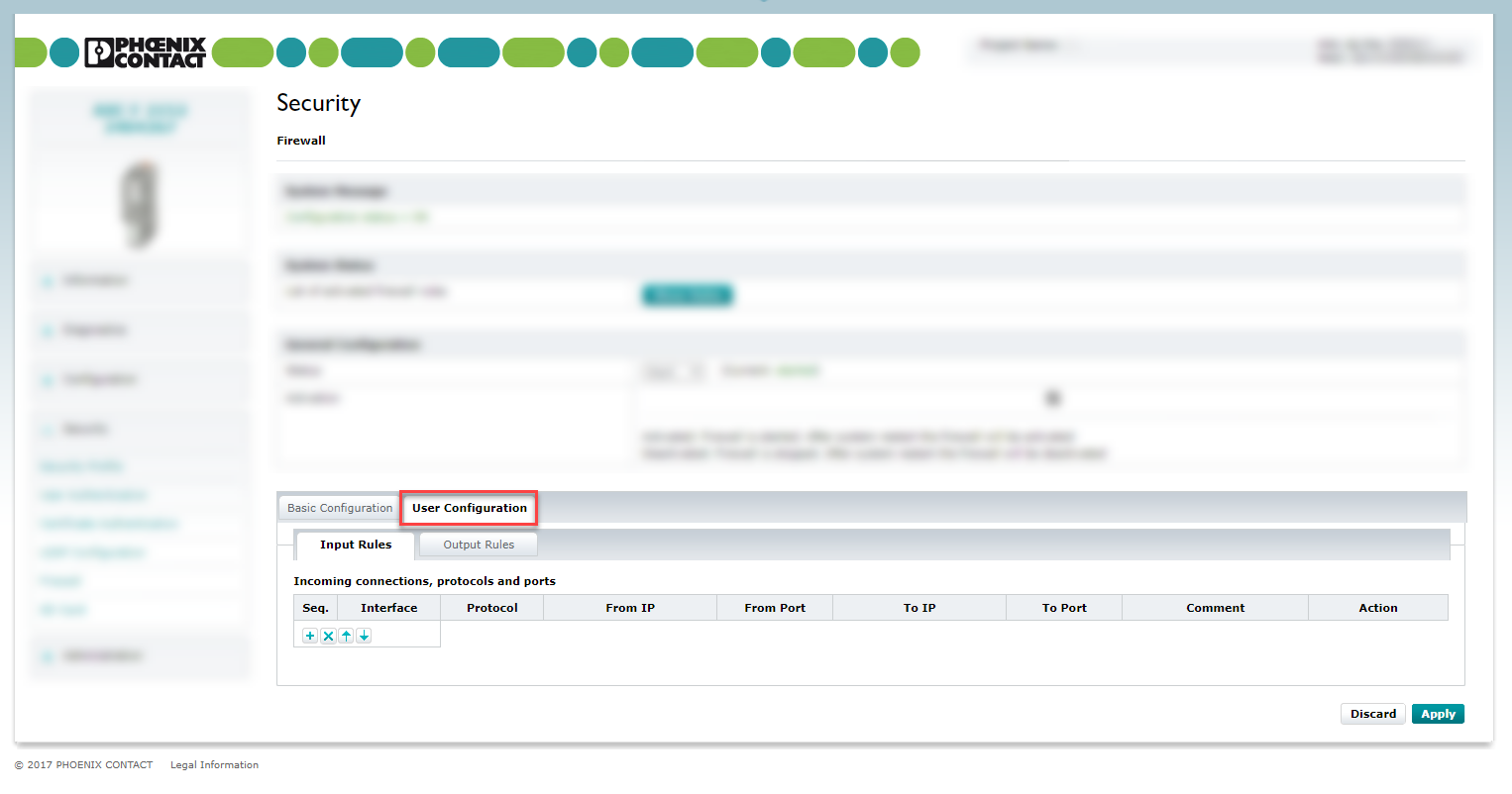

  • Check whether further user-defined settings are necessary for your application.
  • If you need to allow further ports, open the IP INPUT RULES tab or the IP OUTPUT RULES tab.
     For further information see Configuring extended firewall settings topic in this PLCnext Technology ‑ Security Info Center.
