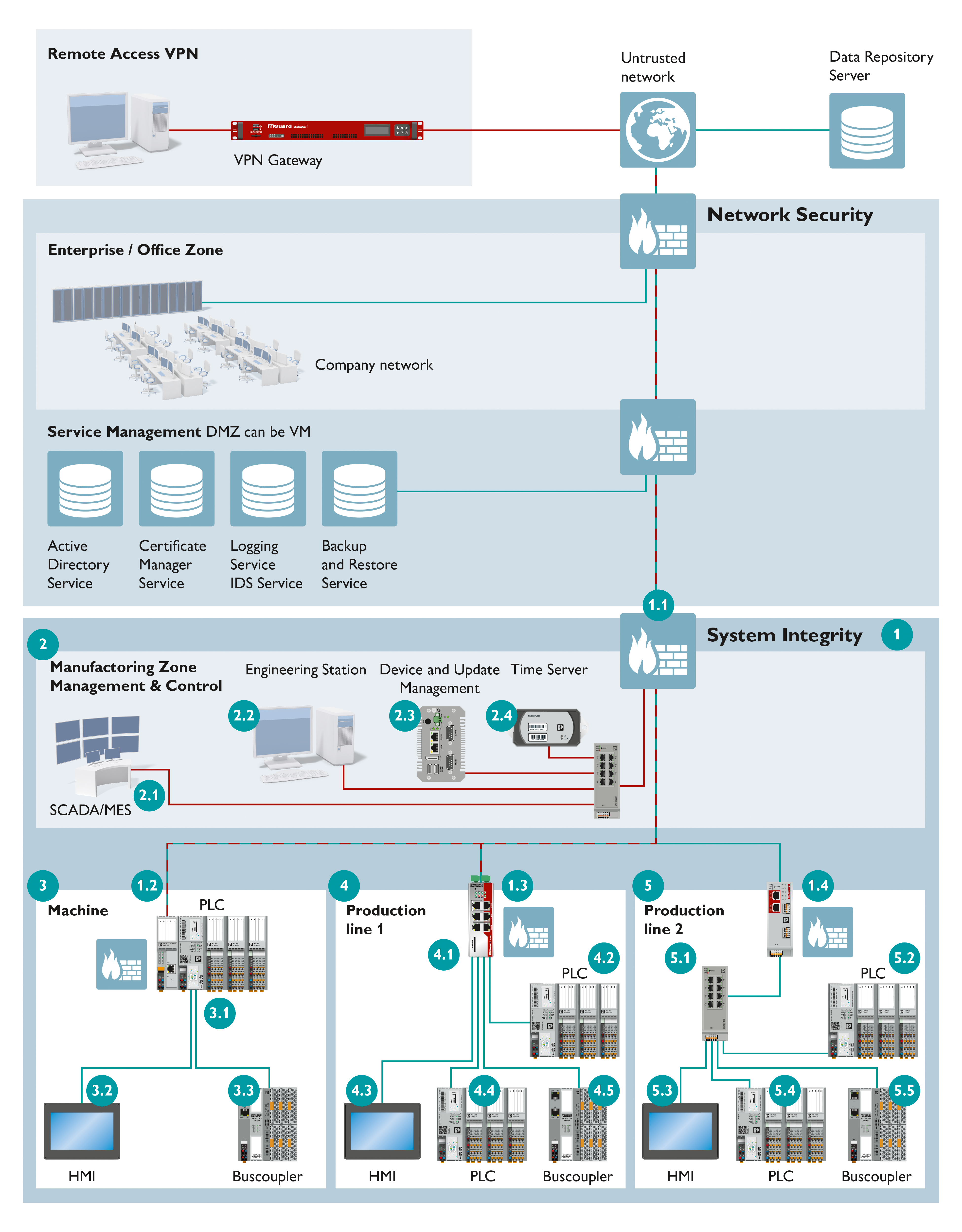

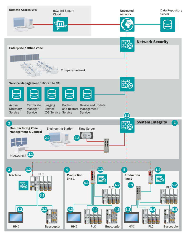

Zone segmentation IP address spaces:
No.  Zone segments IP address spaces Subnetmask
1 System integrity 172.16.10.0/28  255.255.255.240
2 Manufacturing Zone Management & Control 172.16.20.0/24 255.255.255.0
3 Machine 172.16.30.0/26 255.255.255.192
4 Production line 1 172.16.40.0/24  255.255.255.0
5 Production line 2 172.16.50.0/24  255.255.255.0
1   System integrity:   IP addess space 172.16.10.0/28,  Subnetmask 255.255.255.240
No.  Zone segment IP address
1.1 IT firewall network segmentation Manufacturing Zone Management & Control 172.16.10.10
1.2 AXC F 2152 network segmentation AXC F 2152 left pluggable Ethernet connection  172.16.10.30
1.3 mGuard RS 4000 network segmentation firewall and VPN 172.16.10.40
1.4 mGuard 1102 network segmentation firewall 172.16.10.50
2   Manufacturing Zone Management & Control:   IP addess space 172.16.20.0/24,  Subnetmask 255.255.255.0
2.1 SCADA/MES 172.16.20.60
2.2 Engineering Station 172.16.20.100
2.3 Time Server FL TIMESERVER NTP 172.16.20.40
3   Machine:   IP address space 172.16.30.0/26, Subnetmask 255.255.255.192
3.1 AXC F 2152 CPU Ethernet interface 172.16.30.10
3.2 HMI Touch-Panel - TP 6070-WVPS 172.16.30.20
3.3 Buscoupler AXL F BK PN TPS with Smart IOs 172.16.30.30
4   Production line 1:   IP address space 172.16.40.0/24,  Subnetmask 255.255.255.0
4.1 mGuard RS 4000 Local IP Address 172.16.40.5
4.2 AXC F 2152 CPU ethernet interface 172.16.40.10
4.3 HMI Touch-Panel - TP 6070-WVPS 172.16.40.20
4.4 AXC F 2152 CPU ethernet interface 172.16.40.11
4.5 Buscoupler AXL F BK PN TPS with Smart IOs 172.16.40.30
5   Production line 2:  IP address space 172.16.50.0/24,  Subnetmask 255.255.255.0
5.1 mGuard 1102 Local IP Address 172.16.50.5
5.2 AXC F 2152 CPU ethernet interface 172.16.50.10
5.3 HMI Touch-Panel - TP 6070-WVPS 172.16.50.20
5.4 AXC F 2152 CPU ethernet interface 172.16.50.11
5.5 Buscoupler AXL F BK PN TPS with Smart IOs 172.16.50.30
  • First, define a network definition. This is reflected in the first 24 bits of the IP addresses (in the example: 172.16.xx.xxx). Bits 25 to 32 are reserved for the local devices.
  • The Engineering Station (where the PLCnext Engineer is located) has the IP address 172.16.20.100 (255.255.255.0).
  • The Machine Level is configured so that access from the Manufacturing Zone to the Machine Level is via the Ethernet interface of the extension module.
  • The extension module is assigned the IP address 172.16.10.30. The IP address of the PLCnext Control is 172.16.30.10 (255.255.255.240).
