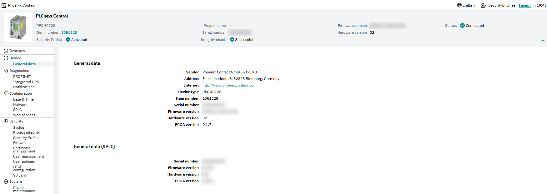

Checking the device (combined safety)
  • Log in to the WBM.
  • Open the General Data page (DeviceGeneral Data).
  • Check whether you are working on the correct device:
    • PLCnext Control RFC 4072S , Order No. 1051328
    • Serial No. as printed on the device
    • Firmware Version min. 2022 LTS
    • Hardware Version min. 02
