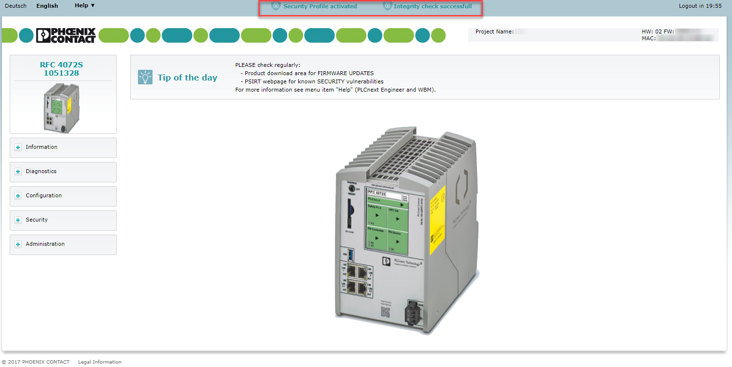

Security Profile is activated and the integrity state check is successful:

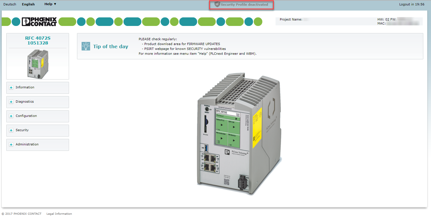

Security Profile is deactivated, the integrity state field is hidden:
