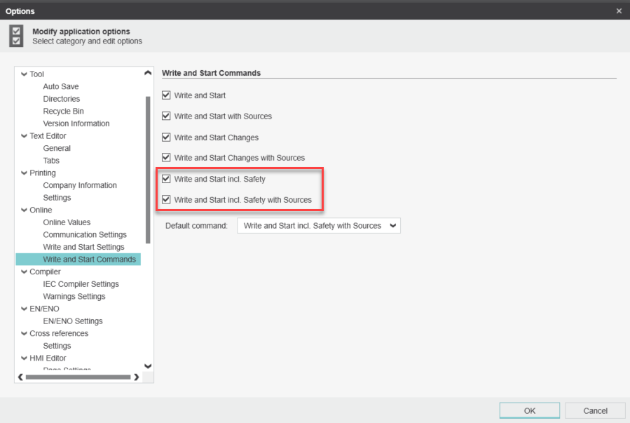

To include the safety-related project when downloading (writing and starting) a project, you must activate the respective checkboxes in the options menu. To do this, proceed as follows:
  • In PLCnext Engineer, open the options menu: ExtrasOptions...
  • Open to Online drop-down menu.
  • Click on Write and Start Commands.
  • Activate the checkboxes Write and Start incl. Safety and Write and Start incl. Safety with Sources.
  • Click the OK button.

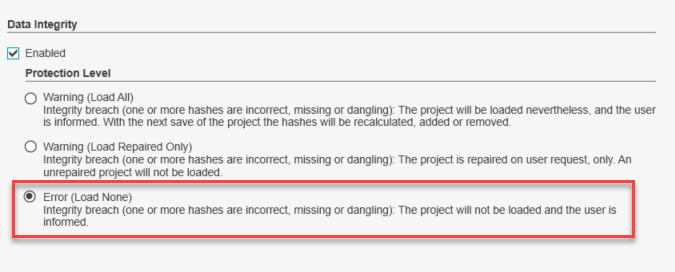

Protection level
Which protection level you should set depends on which project you want to open. In any case you must restart PLCnext Engineer for the changes to take effect.
New project
If you want to create a new project, set the protection level Error (Load None).
In this case, the project is not loaded if an integrity breach is detected and you are informed by a notification in PLCnext Engineer

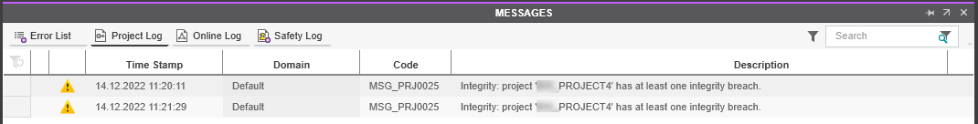

And this is a notification that you will see if your project has an integrity breach:
The notifications are also displayed in the messages window on the Project log tab (example below).

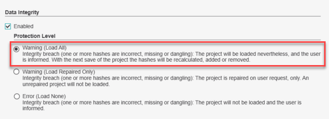

Existing project (PLCnext Engineer version up to 2023.0)
If you want to open an existing project created with a PLCnext Engineer version up to 2023.0, set the protection level Warning (Load All).
Single level libraries are automatically converted, multi-level libraries you have to open and save as a project (this will repair them).
Notifications with protection level Warning (Load All):

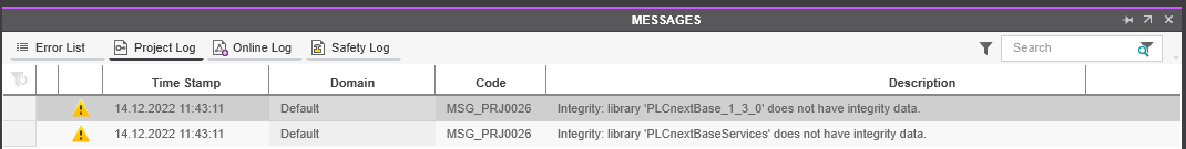

These are a notifications that you will see if libraries in your project have no integrity data:
