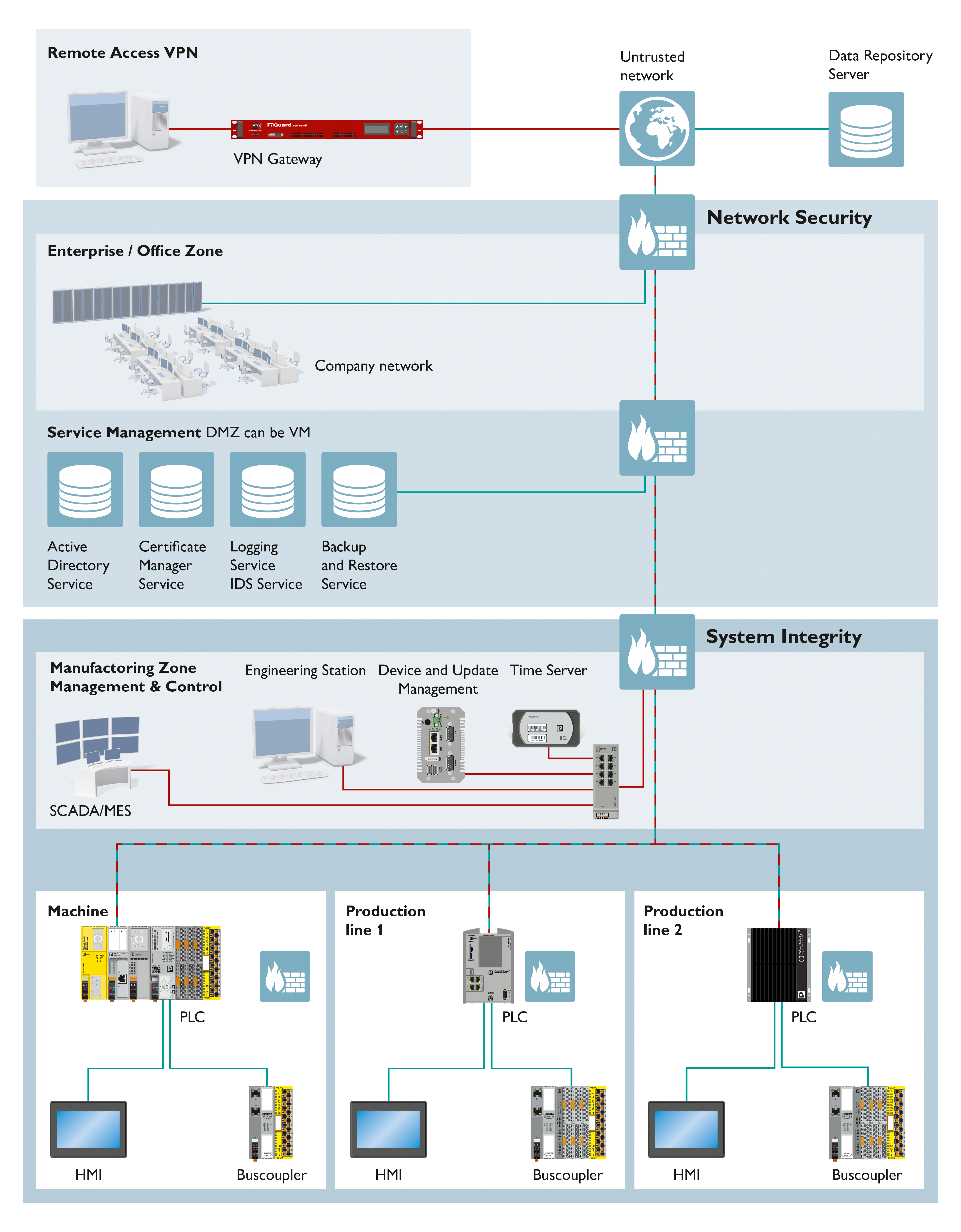

Generic context 1
Controllers used in this context:
  • Machine: SPLC 1000AXC F XT ETH 1TXAXC F XT EXPAXC F 2152
  • Production line 1: SPLC 1000AXC F 3152
  • Production line 2: RFC 4072S with integrated iSPNS 3000
...continuation see next page...

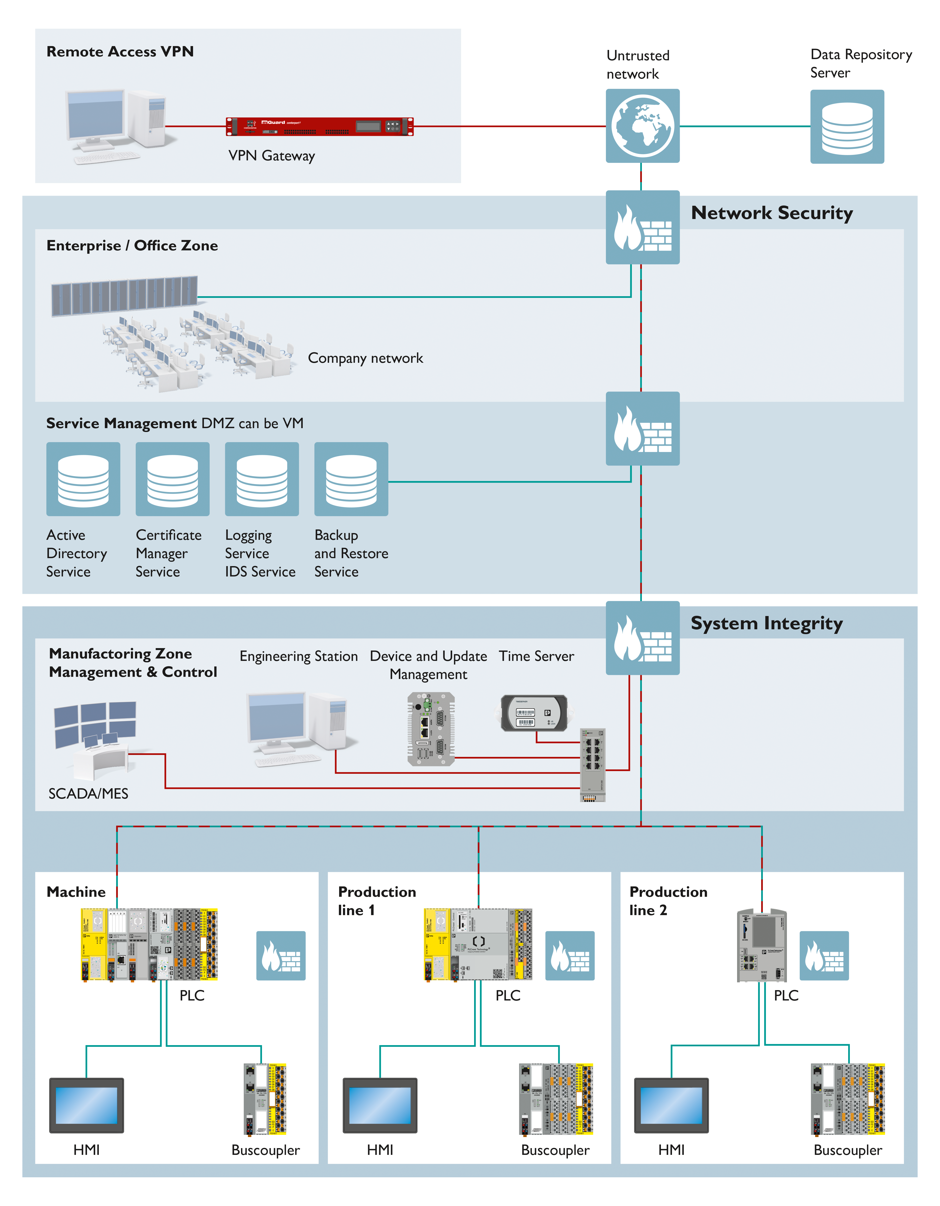

Generic context 2
  • Machine: SPLC 1000AXC F XT ETH 1TXAXC F 2152
  • Production line 1: RFC 4072S with integrated iSPNS 3000
  • Production line 2: BPC 9102S with integrated iSPNS 3000
