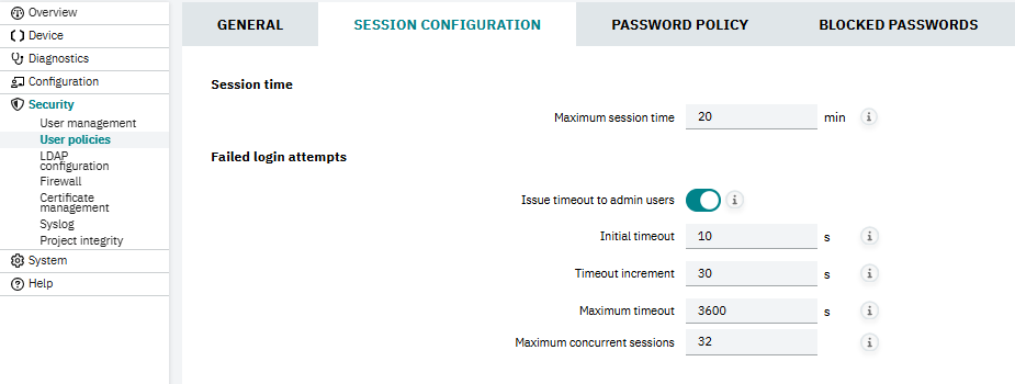

Session Configuration
  • Log in to the WBM.
  • Open the User policies page (Security → User policies).
On the SESSION CONFIGURATION tab, you configure the maximum session time, the timeout penalty times and the maximum number of concurrent sessions.
In the following screenshot you see the default settings:
  • Maximum session time: After 20 minutes of inactivity the session is automatically closed.
  • Issue timeout to admin users:  This setting excludes users from timout for whom the "Admin Ruleset" is stored.
    Note: Check if you really want to exclude users from the timeout and adjust the setting if necessary.
  • Initial timeout: After three failed password attempts, there is a penalty time of 10 seconds.
  • Timeout  increment: After four failed password attempts, there is an additional penalty time of 30 seconds.
  • Maxiumum timeout: The maximum timeout is 3600 seconds. This means that you can then start another password attempt every 3600 seconds.
    Alternatively, you can ask the admin to delete your user and create a new one. Then you can start entering the password again.
  • Maximum concurrent sessions: With this configuration, you define how many communication channels may exist simultaneously. Adjust the value to your circumstances if necessary. Keep in mind the principle of least functionality!
