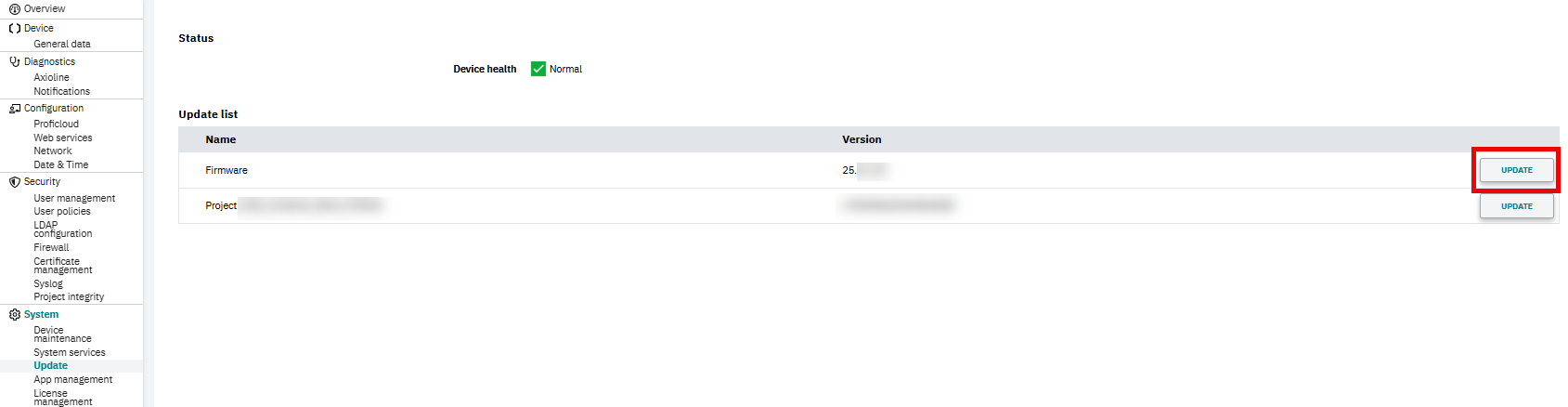

  • Open the Update page (SytemUpdate) in the WBM.
  • Click the UPDATE button of the firmware you want to install on your PLCnext Control.

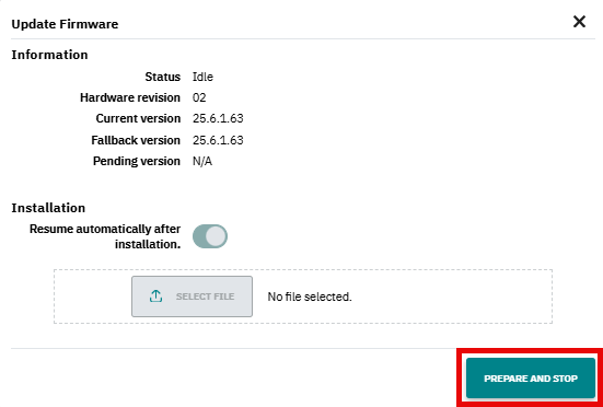

    ↪ The Update Firmware windows opens.

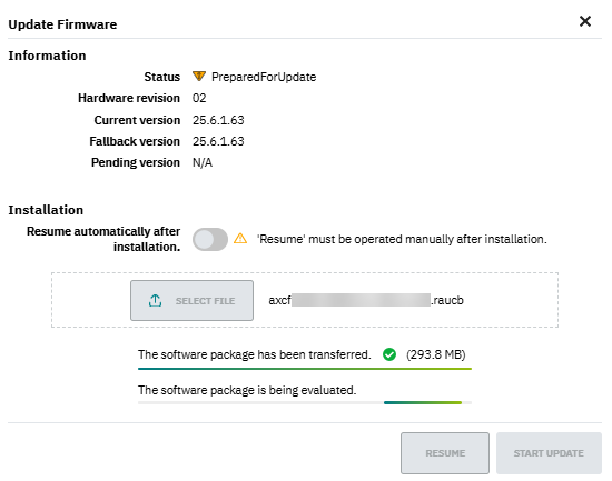

  • Click the PREPARE AND STOP button.

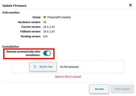

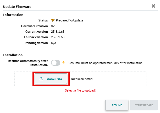

  • When the PLCnext Control is prepared for update, deactivate the toggle switch Resume automatically after installation.

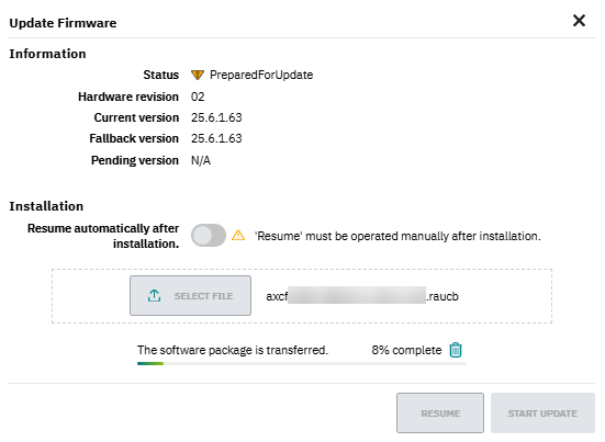

  • Click the SELECT FILE button and select the corresponding firmware file.

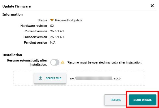

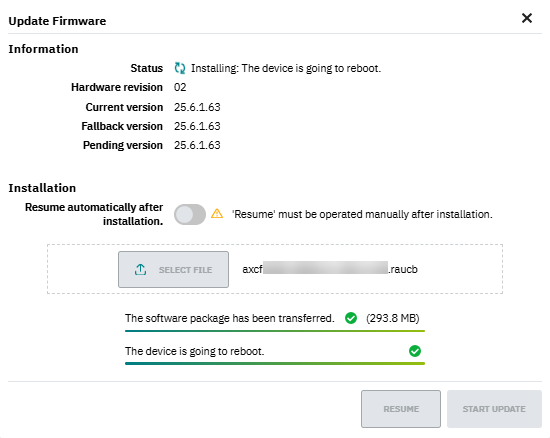

  • Click the START UPDATE button.

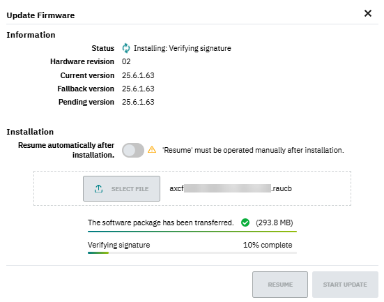

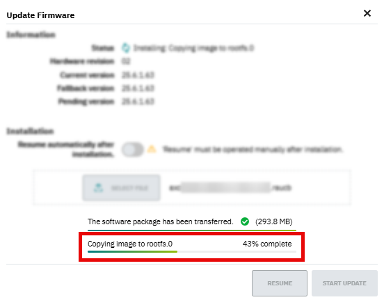

    ↪ The software package is transferred and evaluated, the signature is checked. Then the PLCnext Control is rebooted.
  • Carry out the firmware update again so that it is installed on both partitions.
    The respective partition is displayed during the update process:

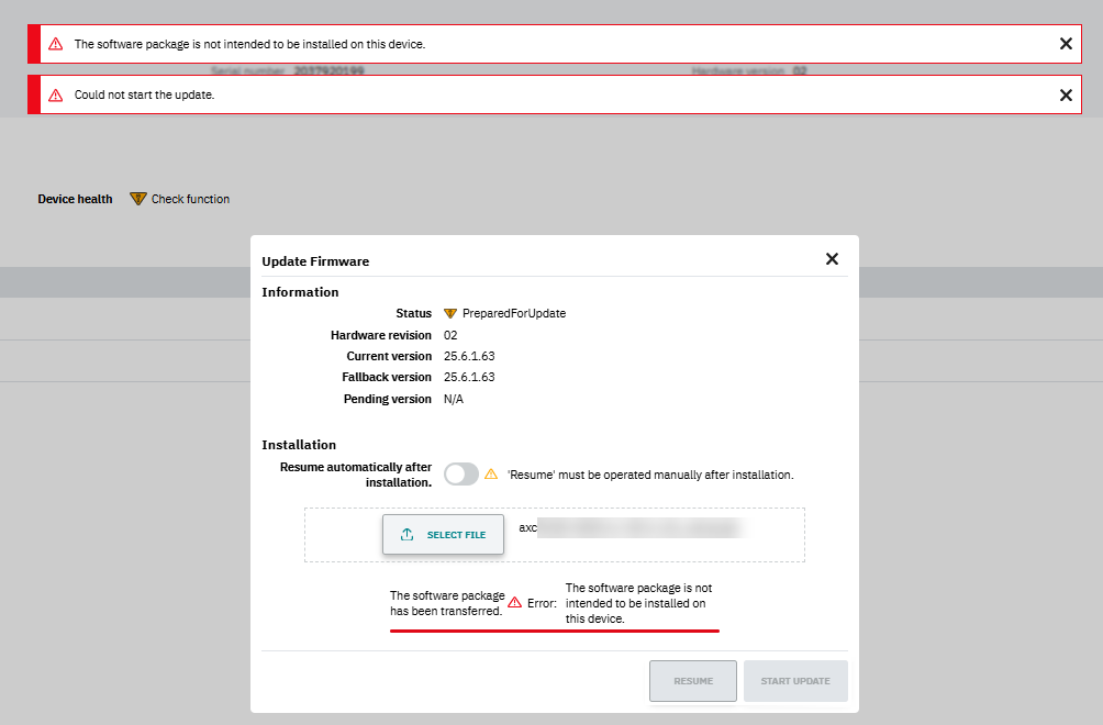

If the signature does not match (i.e. an incorrect signature is stored) or the firmware does not match the signature, a corresponding message is displayed.
