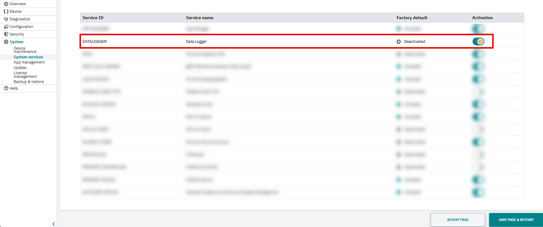

Secure by default: Activating DataLogger
- Log in to the WBM.
- Open a web browser on your computer.
- In the address field, enter the URL https://<IP-address-of-the-controller>/wbm,
- Open the System services page (System → System services) in the WBM.
- Activate the toggle switch of the DataLogger.
- Click the button.
