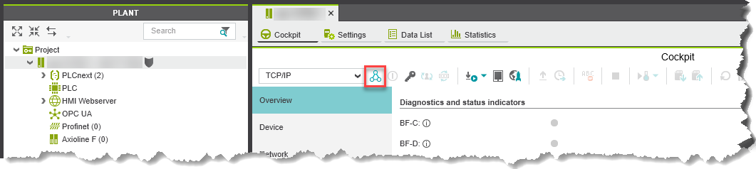

  • Connect PLCnext Engineer to the PLCnext Control by clicking the  button (Connect to the controller to establish communication with online services).

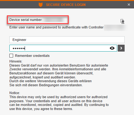

    ↪ The SECURE DEVICE LOGIN opens.
    Note: To ensure that you are connecting to the correct device, you must compare the serial number displayed in the login dialog with the serial number printed on the device.
  • Make sure that you are connecting to the correct device by checking the displayed serial number.
  • Enter your user name and your password.
    Note: You have to log in with the user who has the role "Engineer".

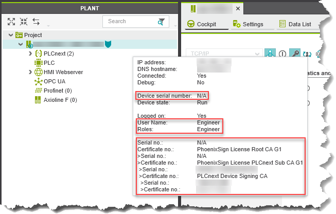

  • Display the context menu of the controller node in the PLANT area via mouseover.
  • Make sure you are connected to the correct device (Device serial number).
  • Check how you are logged in (User Name) and what role you have (Roles).

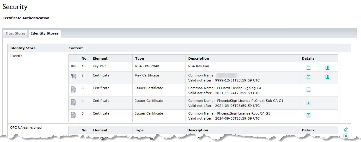

  • The lower section of the context menu lists the certificates and issuers that were applied to the device.
    You can also see this information in the WBM on the Certificate Authentication page on the Identity Stores tab.
