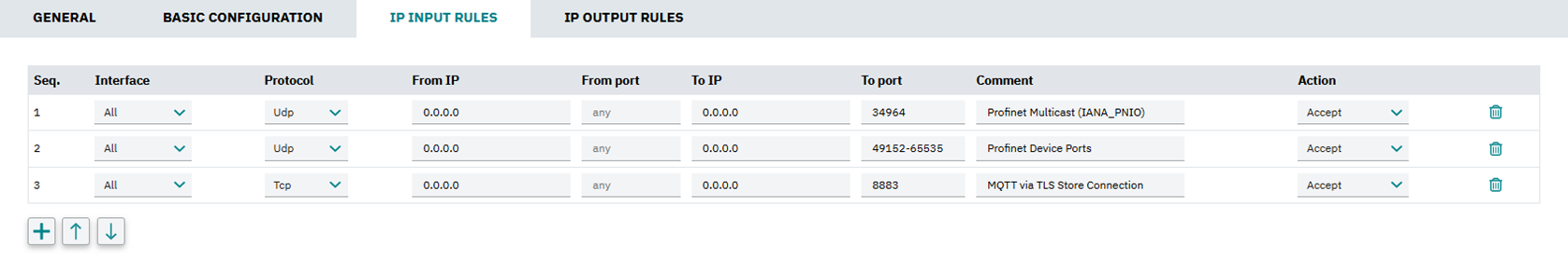

  • Open the Firewall page (SecurityFirewall) in the WBM.
  • Open the IP INPUT RULES tab.
  • Provide the following information:
  • Click the SAVE & APPLY PAGE button.

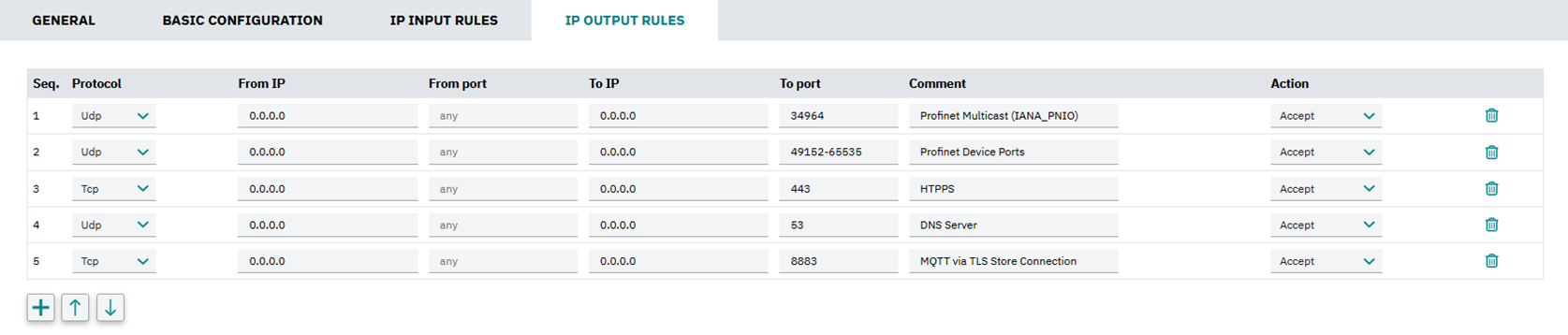

  • Open the IP OUTPUT RULES tab.

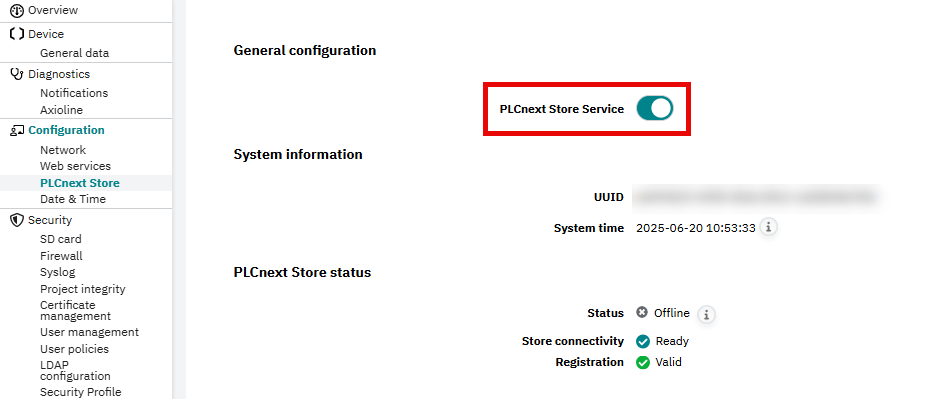

Activating PLCnext Store on the PLCnext Store page
  • Open the PLCnext Store page (ConfigurationPLCnext Store) in the WBM.
  • Activate the toggle switch of the PLCnext Store Service .

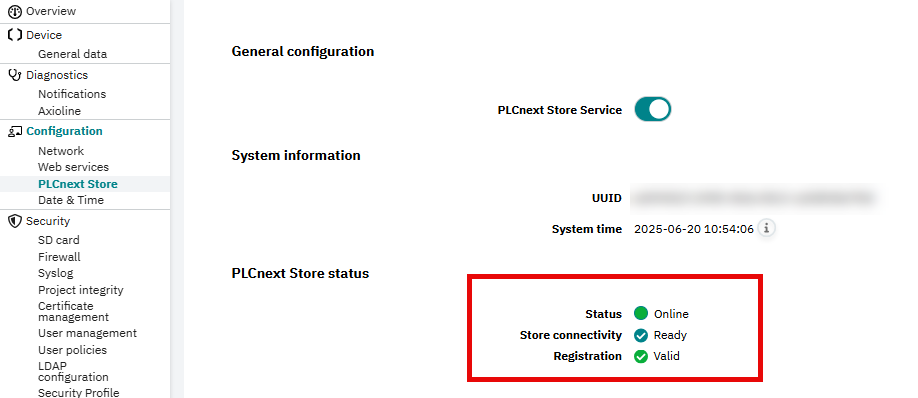

The PLCnext Store status should now look like this:
If there are connection problems, go to the PLCnext Store and check that the device is correctly added and connected. You can find information on this in the PLCnext Store Info Center.

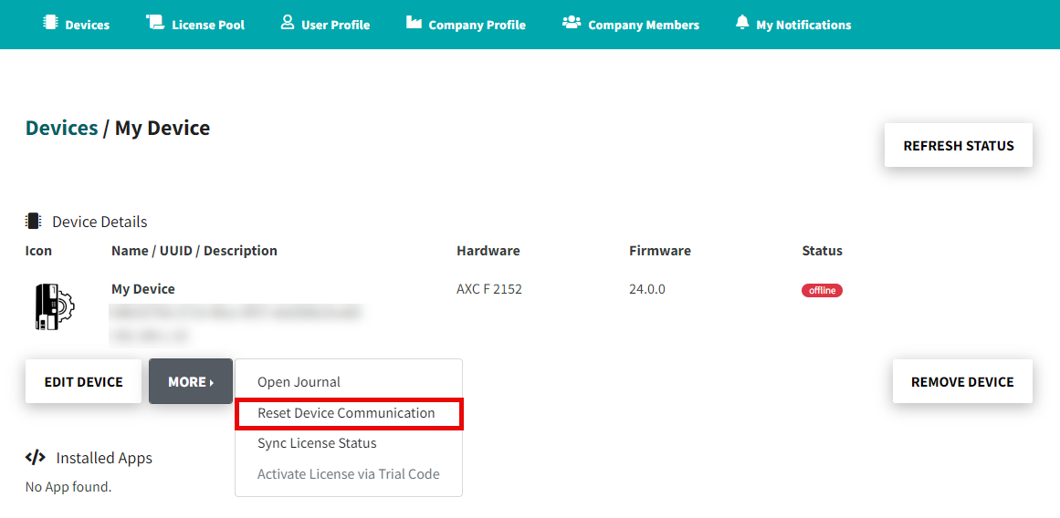

Restore PLCnext Store connection after reset
After resetting the controller to reset type 1 or 2, the PLCnext Store is no longer accessible (No registration token available).
To reset the device communication, proceed as follows:
  • Log in to the PLCnext Store, using your PLCnext Store account credentials.
  • Open your device list.
  • Select the device you want to put back online.
  • Click the More button.
  • Chose Reset Device Communication.
    This will automatically create a new security token for your device. This security token is automatically stored in the device and authenticates you as an authorized user.
