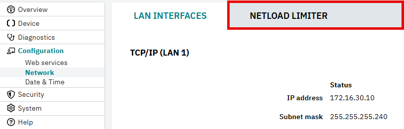

You configure the Netload Limiter on the Network page (Configuration → Network) in the WBM.
  • Log in to the WBM.
  • Open the Netload Limiter tab.
