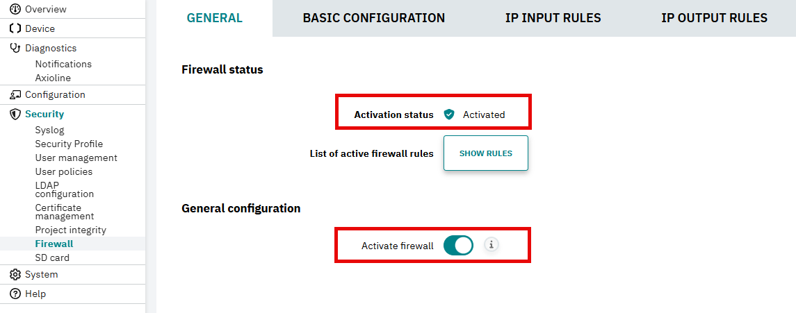

  • Log in to the WBM.
  • Open the Firewall page (SecurityFirewall) in the WBM.
  • On the GENERAL tab, check in the Firewall status section whether the activation status is "activated" and in the General configuration section whether the checkbox Active firewall is activated.
