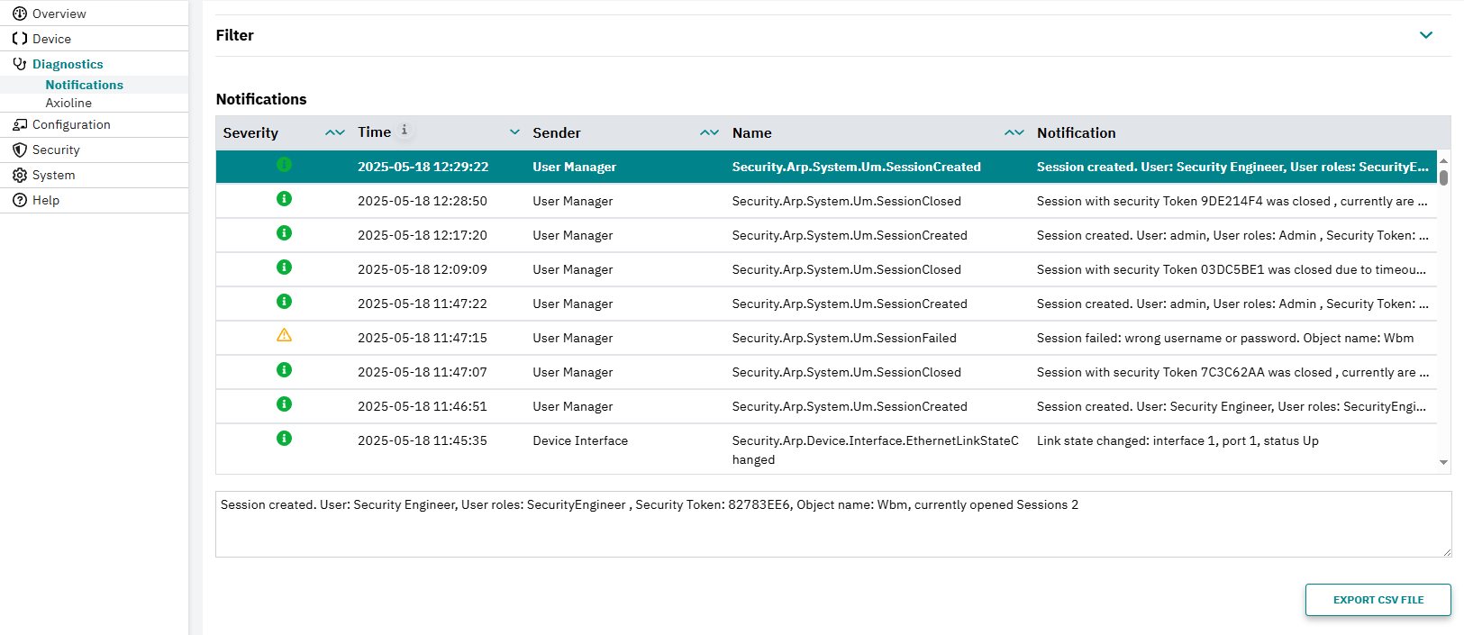

  • Log in to the WBM.
  • Open the Notifications page (DiagnosticsNotifications).
Note: The Admin, the Security Engineer and the Security Auditor have access to the security notifications.

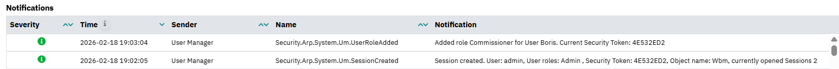

The UserManager assigns a Security Token to each user who logs in. The Security Token is displayed at the corresponding notifications for all activities.
The security token is a representation of a user logged in to PLCnext.
In the notifications, it replaces the user name with a series of characters.
When the user logs in for the first time, a notification is generated that assigns the user name to the security token.
For all subsequent actions, only the security token is used to identify the user.
Example: The user admin receives the Security Token 4E532ED2. The user is identified by this Security Token in the following messages (see the following screenshot).
The Security Engineer and the Security Auditor have access to the security logging. On the basis of the notifications it is possible to see how the PLCnext Control is booted (whether the integrity is given) and general information about all activities of the logged-in users (who changed what when and how) in the sense of non-repudiation according to IEC 62443.

Note: To see all messages and remove the filter, click the RESET FILTERbutton.
