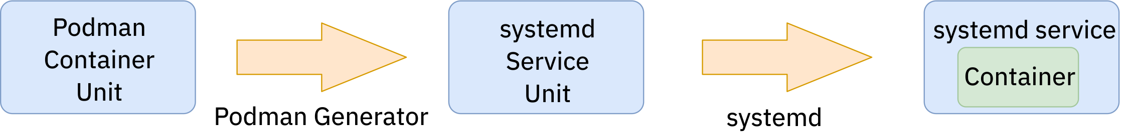

This app part provides the possibility for simplified integration and run of OCI (Open Container Initiative) container images of apps on the PLCnext Technology device. For this topic the container engine Podman is used in conjunction with systemd to allow efficient and reliable management of containerized applications, leveraging Podman's rootless and deamonless architecture while maintaining full control over service management through systemd.
An OCI container will run although as a systemd service. Which means that systemd starts the containerized application and manages its entire lifecycle (start, stop, etc.). That will bring further useful functionalities such as:
  • Automatically starting the OCI container service on system boot
  • systemd features such as defining the order in which the containerized service runs and needed dependency checks
  • Service restart on error
The integration of OCI containers to systemd is done via Podman systemd units (formerly named Quadlets). For this purpose the app developer creates corresponding Podman unit files for the OCI container. The app part allows to define container services (*.container), pods (*.pod) and networks (*.network) unit files. The Podman generator converts the Podman unit files (formerly Quadlet files, see Minimal systemd unit file) to systemd service unit files, see Podman generate systemd.
