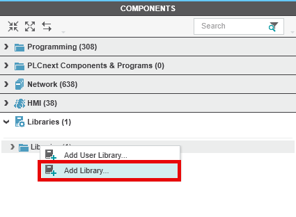

We offer the function block LICENSE_STATUS to protect a PLCnext Engineer project or library. The function block LICENSE_STATUS is available in the software PLCnext Engineer in the PLCnext Controller library. The library PLCnext Controller is not loaded by default. You must first add it in the COMPONENT area via Add Library....
Add the firm code and product code to the function block LICENSE_STATUS.
