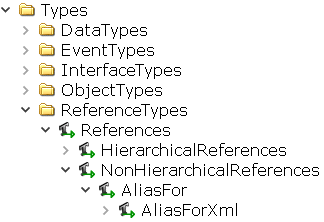

Alias Names are nodes that have AliasNameType and are organized by the the AliasNameCategoryType folder Aliases, below Objects
By default no Alias Names are created and the Aliases folder does not exist. Alias nodes are created through external information models. Refer to Integration of external information models for further information.

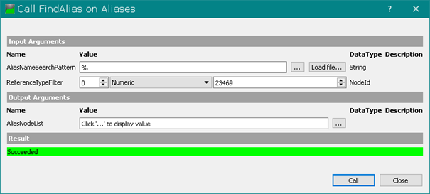

Calling FindAlias requires two input arguments:
  1. The AliasNameSearchPattern input argument should not be empty. It supports wildcard characters according to the OPC UA Online Reference
    For example, use % to match any string.
  2. The ReferenceTypeFilter input argument should be the AliasFor (i=23469) ReferenceType or a subtype of AliasFor to further filter the results.

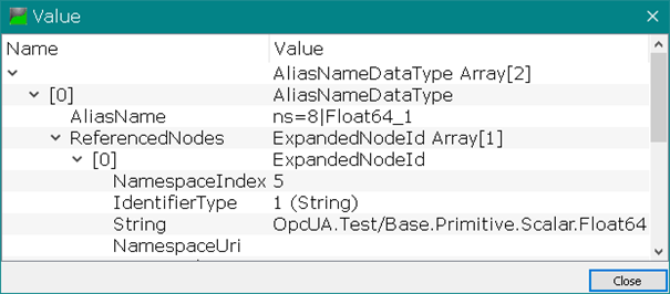

The output is an array of AliasNameDataType that match AliasNameSearchPattern and ReferenceTypeFilter. Each  array element contains an array of ReferenceNodes to AliasName, since one AliasName can reference multiple nodes.
Note: FindAlias recursively searches all AliasNames in the corresponding AliasNameCategory.
