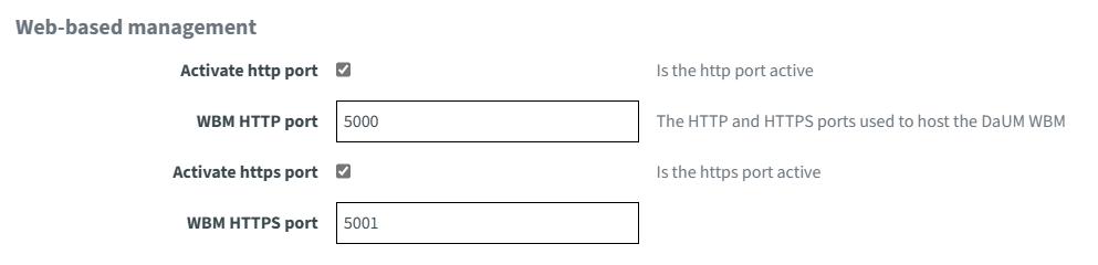

WBM via HTTPS
Available from DaUM version 2025.6
The access to the WBM of the DaUM is via a secure connection by default. The DaUM generates a self-signed WBM server certificate the first time it is started and uses this certificate to secure the connection. The admin can change the initial self-signed certificate at a later time.
For containerized implementations, you can set up an additional reverse proxy setup to secure the connection. In such a scenario, you should still be able to configure a (non-encrypted) HTTP port for the WBM via the administration settings.

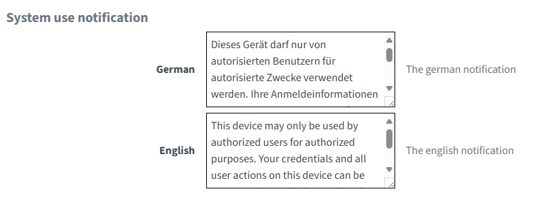

System use notification
The system use notification displayed below the login is configurable, as it may not be suitable for all customers and areas of use.
