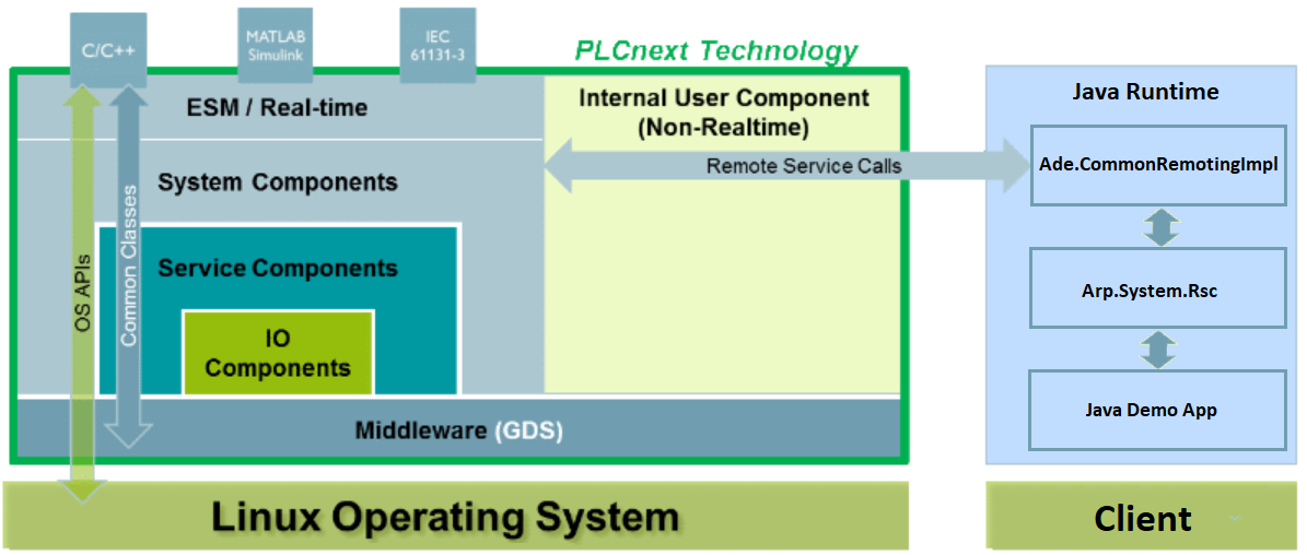

The purpose of this section is to enable you creating Java™ applications and communicate with PLCnext Technology RSC services.
Java knowledge is required.
The sub project com.phoenixcontact.commonremoting (Java module: com.phoenixcontact.ade.commonremoting) contains the API to communicate with the RSC gateway of a PLCnext device.
The module com.phoenixcontact.commonremoting.implementation (Java module: com.phoenixcontact.ade.commonremotingimpl) is an implementation of the API to communicate with the RSC gateway of a PLCnext device and execute remote service calls.
com.phoenixcontact.rsc.common (Java module: com.phoenixcontact.arp.system.rsc) uses the API implementation to communicate with the RSC gateway of a PLCnext device and contains certificates and classes for the validation of the SSL connection.
And the public RSC service interfaces are inside the com.phoenixcontact.rsc.services (Java module: com.phoenixcontact.arp.system.rsc.services).
