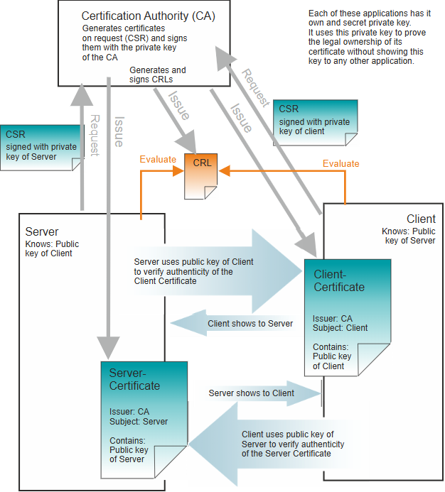

Example illustration
A CA has issued certificates for a server and a client application on request. This represents a two-level certification hierarchy.
Mutual authentication: To authenticate their identities, each application verifies the certificate of the other application using the public key of the other application. Following the successful authentication, a secure communication channel can be established.
The CA has additionally issued a CRL. The application can use this CRL during authentication to ensure that a certificate that to be authenticated is not revoked. Communication is only established if the involved certificate is not listed in the CRL.
