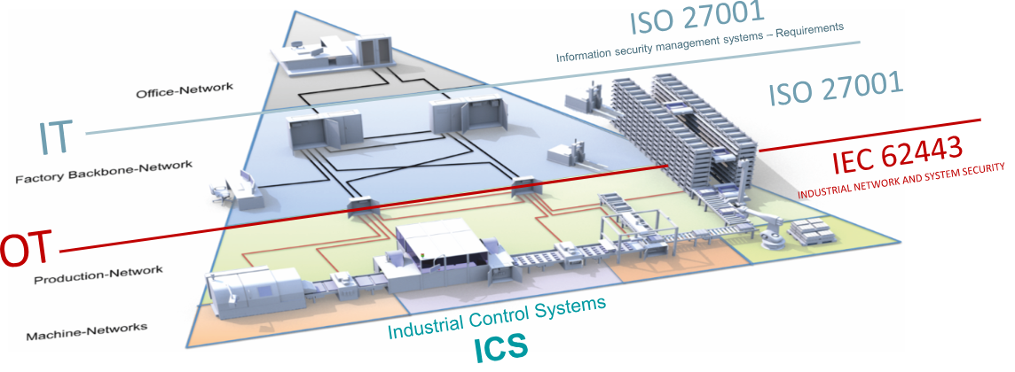

With regard to security, a distinction must be made between different types of technology or networks:
  • IT Information Technology Office (accounting, sales, management, ...).
    Here, the ISO 27001 standard for the plant owner is typically applied.
  • "Intermediate Layer" Factory Backbone (inventory management etc.).
    Enterprise Resource Planning (ERP) or Product Lifecycle Management (PLM) domain, no classic automation.
    Here, the ISO 27001 standard is typically applied.
  • OT Operational Technology Production area / Factory Floor with its machines and plants (ICS).
    Here, the IEC 62443 standard is typically applied.
The following figure illustrates the so-called "Automation Pyramid" with these network types:
In terms of security, these technology areas must not be considered separated from each other. Rather, they must be considered in conjunction. In order to completely serve security in OT, the measures defined by IT must be extended by additional relevant activities.
In the field of automation, the focus is on physical processes such as drilling, measuring, assembling, etc. Plants are operated as long as they allow economical production. The life cycle is much longer than in an IT environment. The broader challenges in automation are apparent: Any disruption leads to reduced productivity. In addition, the possibilities for eliminating vulnerabilities are limited, since restarts are only feasible to a limited extent and every change to an automation system entails the risk of further malfunctions.
