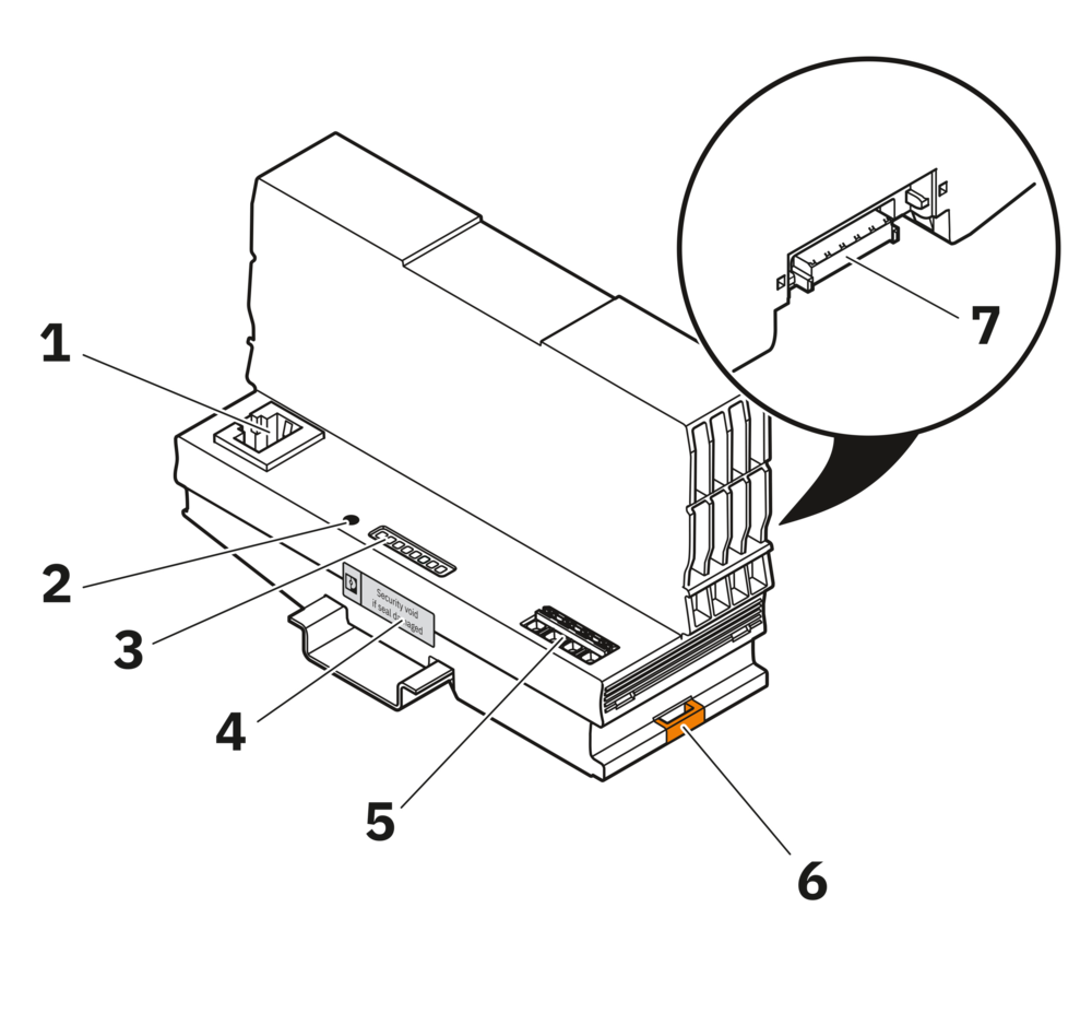

Connecting and operating elements
The controller consists of the following components:

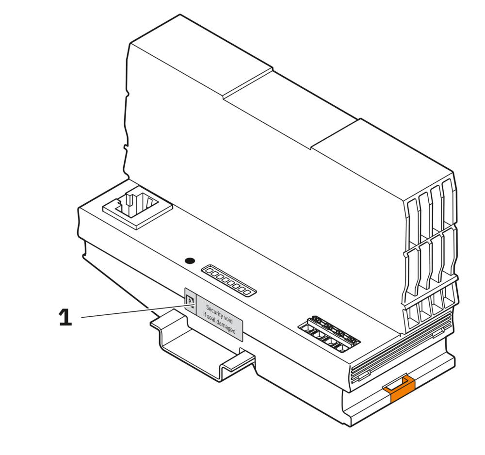

Security seals
In order to prevent manipulation of the device supplied and to detect unauthorized opening of the device, security seals have been applied to the controller.
These security seals are damaged in the event of unauthorized opening. In this case, correct operation of the PLCnext Control can no longer be ensured.
  • Check the delivery for transport damage. Damaged packaging is an indicator of potential damage to the device that may have occurred during transport. This could result in a malfunction.
  • Do not open the housing. If the housing is opened, the function of the device can no longer be ensured.
  • Check at regular intervals that none of the seals are damaged. If any of the seals are damaged or missing, it may be that the device has been tampered. In this case, contact Phoenix Contact without delay before using the device.
1  Security seal

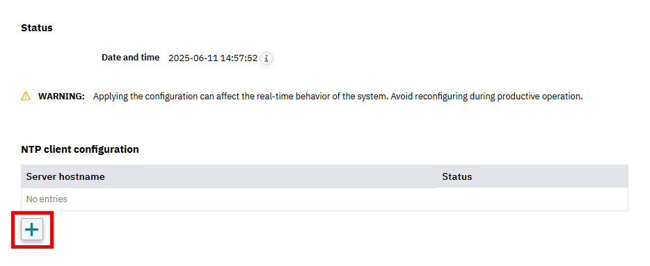

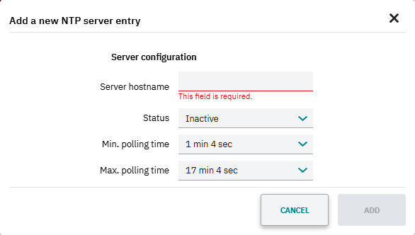

To add an NTP server, proceed as follows:
  • Log in to the WBM.
  • Return to topicHow do I get to the WBM again? Click here for more information...
  • Open the Date & Time page (Configuration → Date & Time).
  • To add a new NTP server entry, click the button.
    ↪ A new window opens.
  • Provide the following information:
    • Server hostname: IP address of the NTP server
    • Status: Active
    • Min. polling time: The shortest interval at which the NTP client retrieves the current time from the NTP server.
    • Max. polling time: The longest interval at which the NTP client retrieves the current time from the NTP server.
    • Note: The relationship between the minimum and maximum polling time is that together they determine the frequency of the time queries. The NTP client dynamically adjusts the polling intervals within these limits based on the stability and accuracy of the time source and the network conditions.

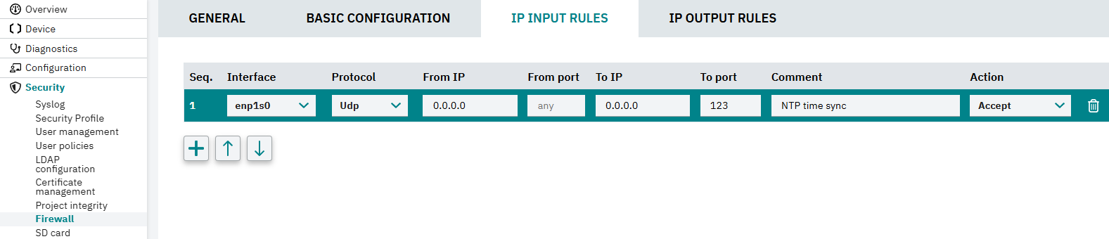

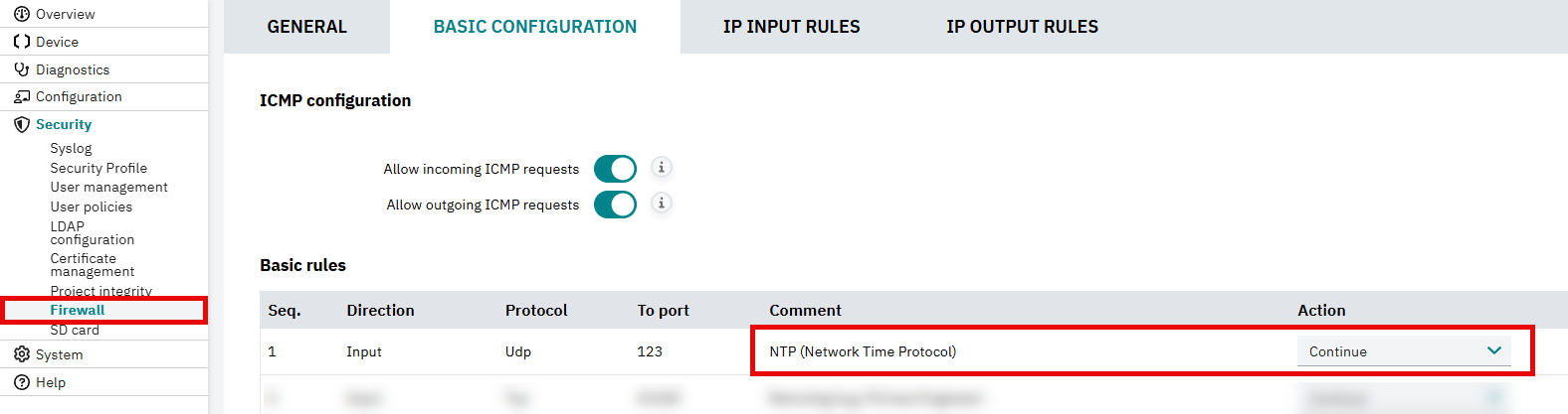

Note: Make sure that the firewall basic configurations and the input rules on the Firewall page (Security → Firewall) in the WBM are correct:
Basic Configuration:
Input Rules:

  • Open the Firewall page (Security → Firewall) in the WBM.
  • Open the BASIC CONFIGURATION tab.
  • In the Basic Rules section, select Continue from the drop-down list for the Remoting in the Action column.
  • Click the SAVE & APPLY PAGE button.

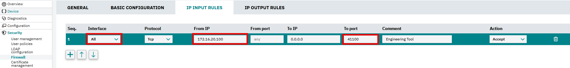

  • Open the IP INPUT RULES tab.
  • Add a new rule via the .
    • Select the interface (refer to the topic of the respective controller).
    • Enter the corresponding IP address (the IP address of the Engineering Station in the superordinate network, refer to the topic Deriving IP addresses).
    • Enter the target port (refer to the topic Configuring basic firewall settings ).
    • Select Accept  in the Action column.
    ↪ Now you have access from the superordinate  network (e.g. PLCnext Engineer).

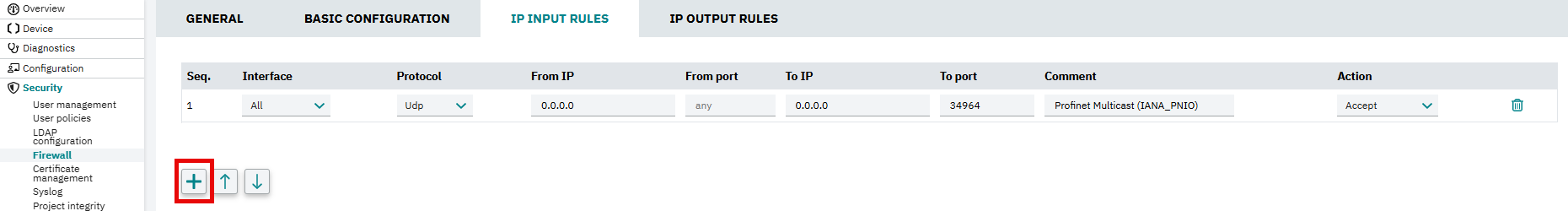

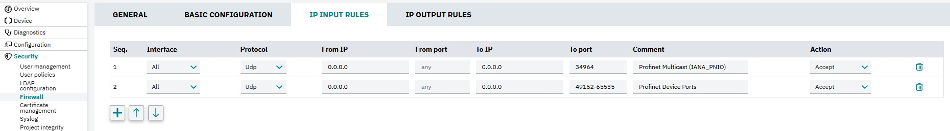

Operation as PROFINET device
    • Select the interface.
    • Select the protocol.
    • Enter the target port (here: 34964).
    • Select the Accept in the Action column.
  • On the IP INPUT RULES tab, add another new rule via the .
    • Enter a target port (here: 49152-65535).
    • Select the action Accept.

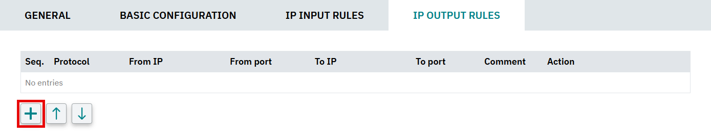

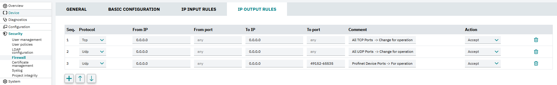

  • Open the IP OUTPUT RULES tab.
    • Enter the target port.

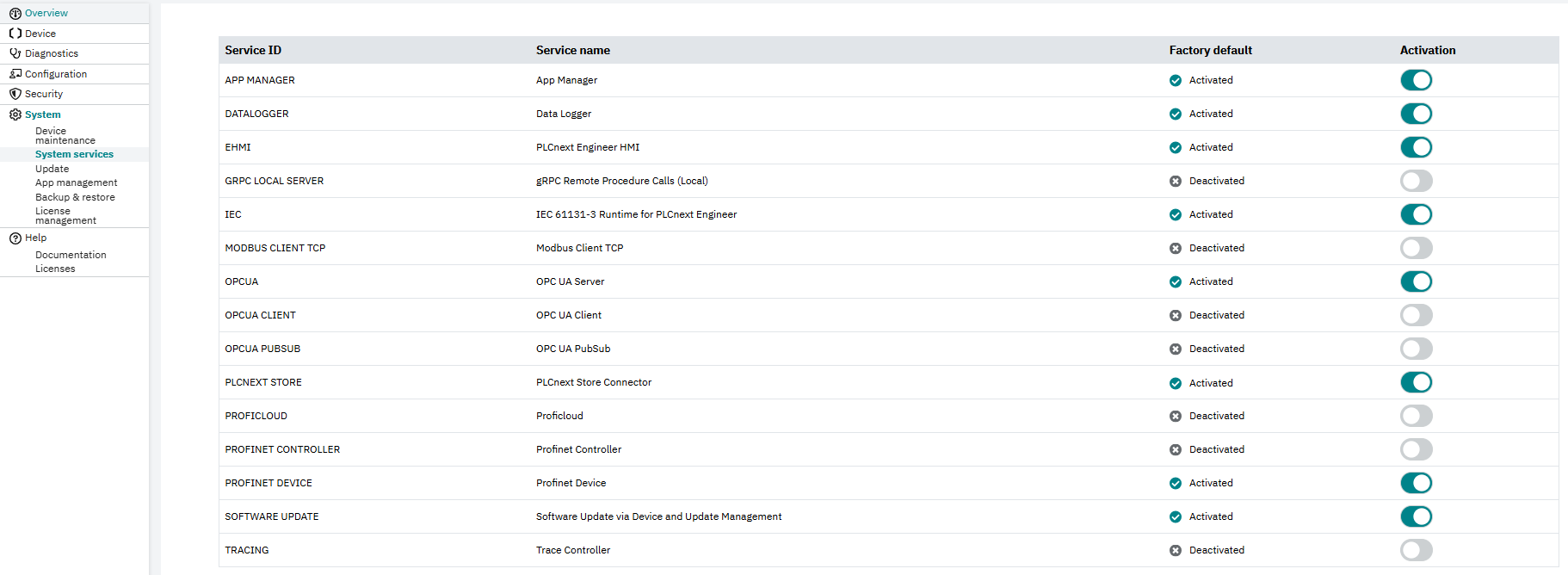

Configuring system services
Security icon
Activating further system services can compromise security
Before activating further system services, you must perform a risk and threat analysis of the system service and its impact on the security of the device and the application, taking into account the overall security context.
The following system services (System → System services  in the WBM) are activated by default for secure-by-default devices:

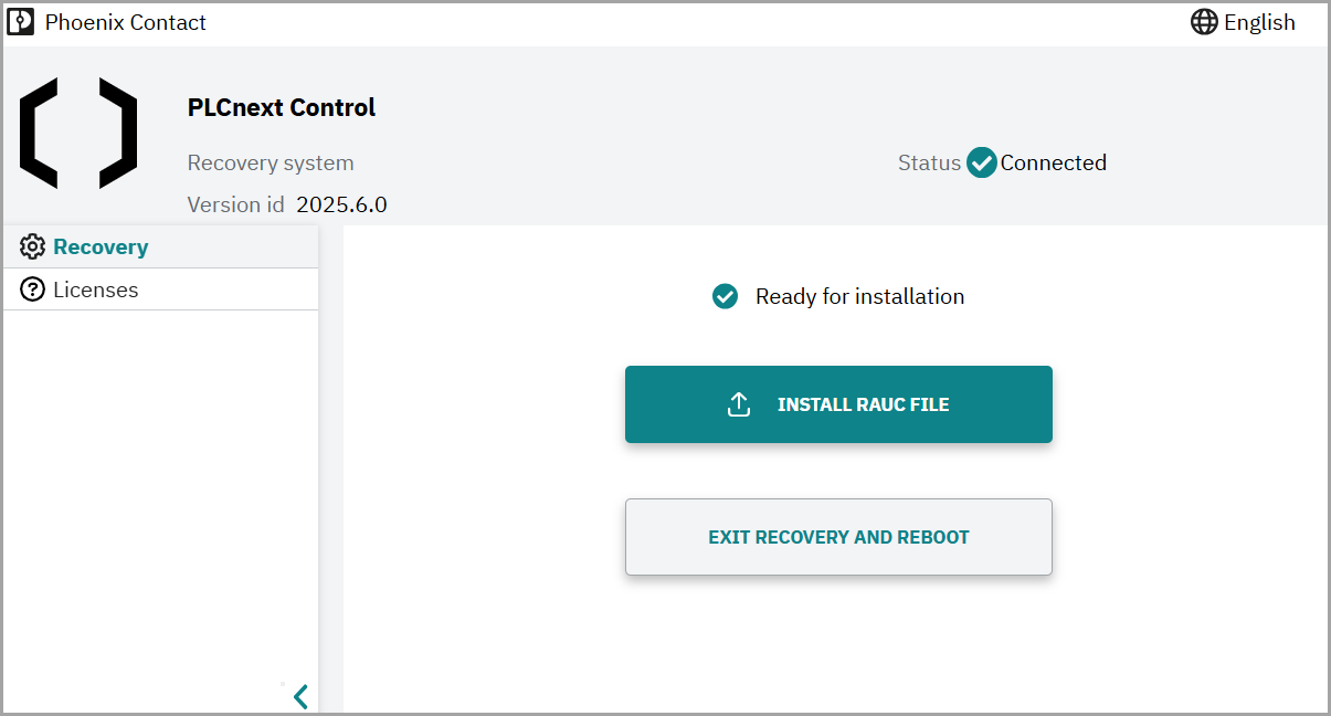

  • Connect the controller to your PC using a suitable Ethernet cable.
  • Open your web browser.
  • Open the recovery system via the URL http://192.168.1.10.
    If the recovery system does not open:
    Check whether the URL you entered in the web browser actually starts with “http://”.
    The recovery system cannot be opened via an HTTPS connection.
    Please note:
    • As long as the recovery system is active, the LNK and ACT LEDs on the Ethernet interface are switched off (even when the Ethernet connection is active).
    • As long as the recovery system is active, the reset button has no function.
You can perform the following actions in the recovery system:
  • Install new firmware
  • Restart the controller with the existing firmware
