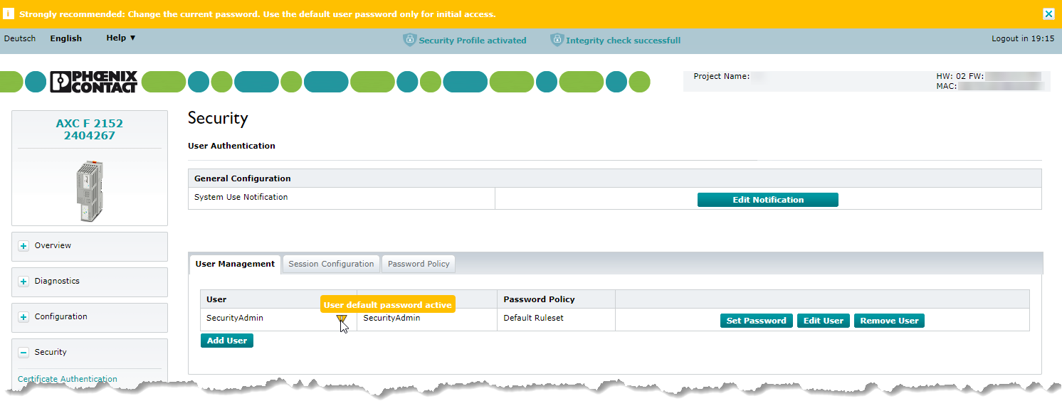

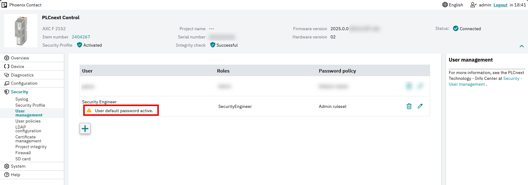

Note: It is strongly recommended that you only use the default user password for the first access. Change the default password immediately after the first access. Observe the password complexity rules .
If you have created a user, you will see a corresponding message in the WBM to change the default password (from firmware 2024.0 LTS).

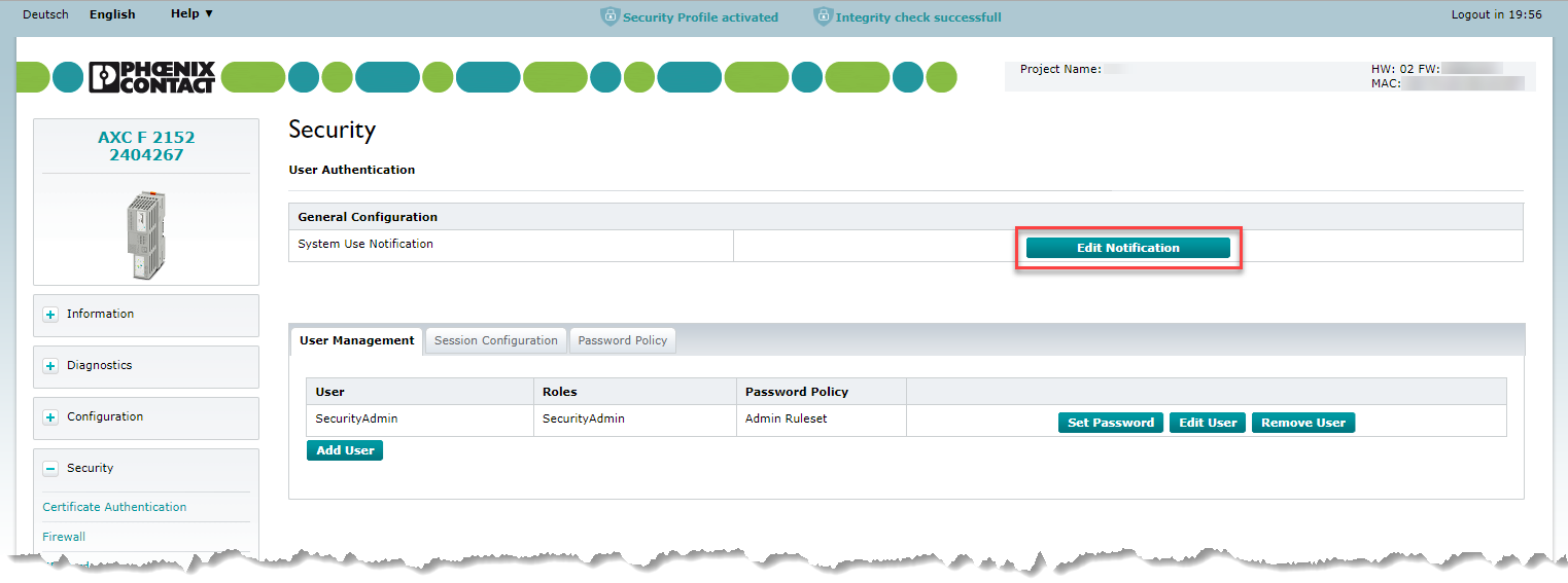

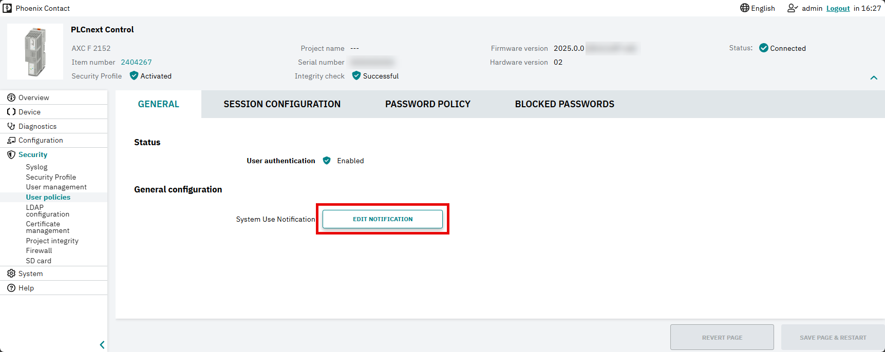

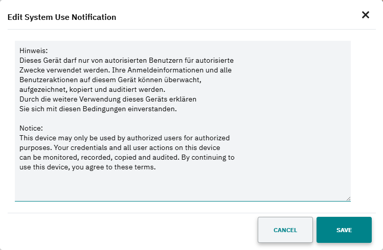

System Use Notification
The system use notification is displayed each time a user wants to log on to the controller. The system use notification is independent of the language of the user interface in WBM and PLCnext Engineer. You should therefore take all required languages into account when editing.
To edit the system use notification, proceed as follows:
  • Log in to the WBM.
  • Open the User policies page (Security → User policies) in the WBM.
  • On the GENERAL tab, click the EDIT NOTIFICATION button.
    ↪ An input window opens.
  • Edit the System Use Notification.
  • Confirm the entry by clicking the Save button.
    ↪ The text is then transferred to the controller and stored.

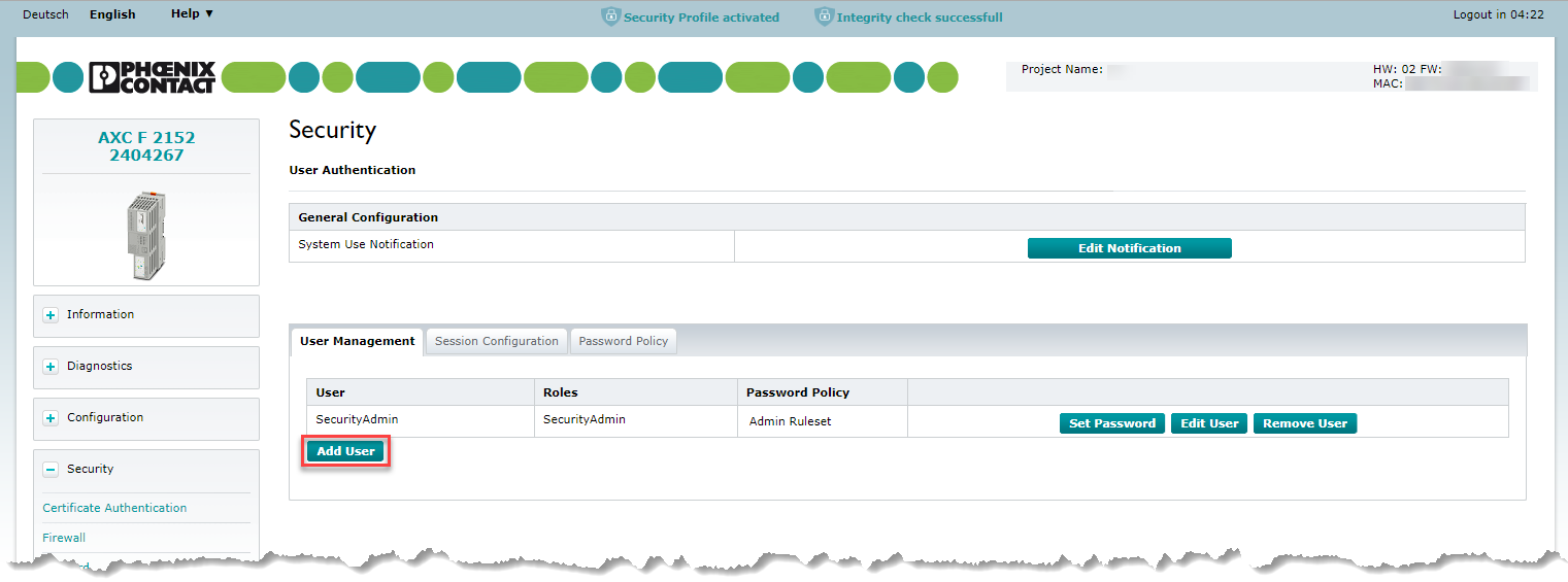

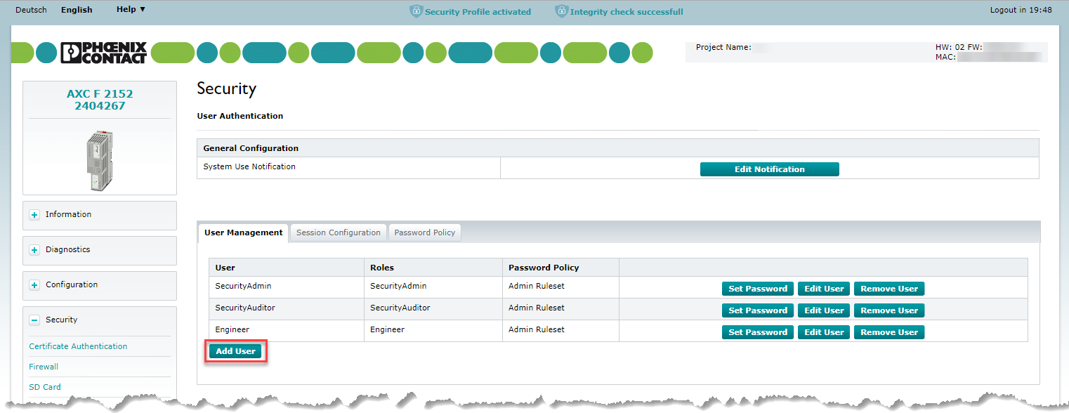

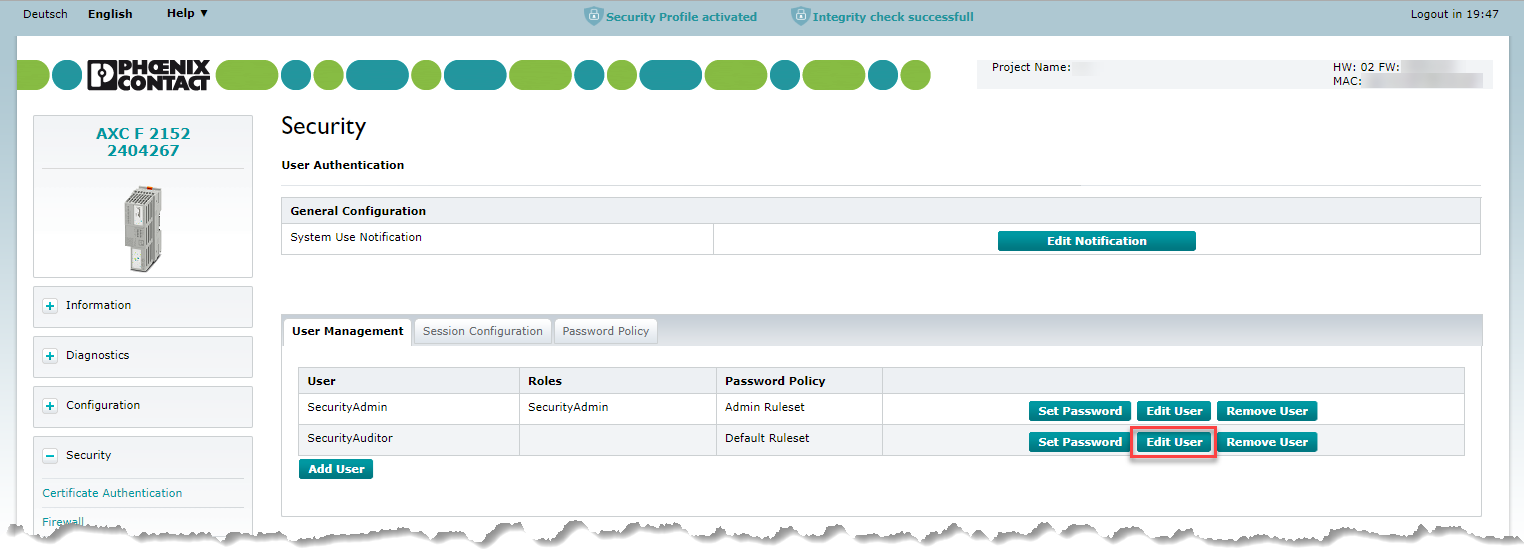

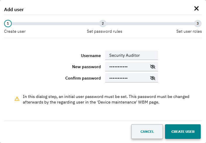

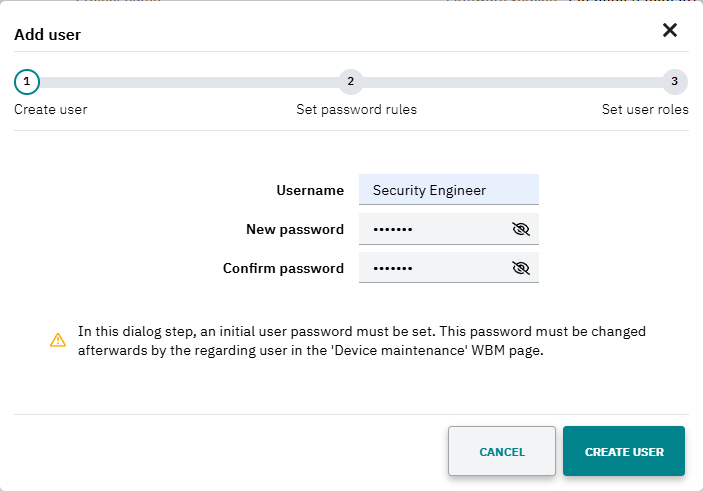

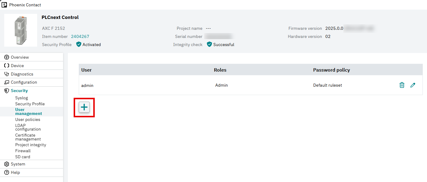

Adding a Security Engineer
To add a Security Engineer, proceed as follows:
  • Open the User management page (Security → User management) page in the WBM.
  • Click the + button.
    ↪ The dialog Add User opens.

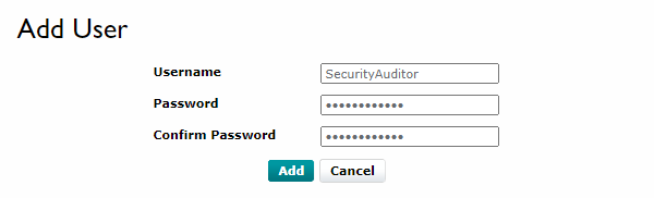

  • Enter a username and the initial password following the password complexity rules.
    Add user via WBM
  • Click the CREATE USER button.

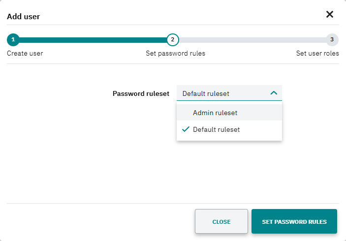

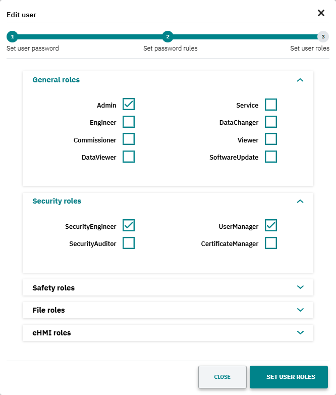

  • Select a password ruleset (the Admin ruleset is strongly recommended) and click the SET PASSWORD RULES button.
  • Select the security roles SecurityEngineer  and UserManager.
  • Click the SET USER ROLES button.
    ↪ You have added a Security Engineer.
  • When you log in as a Security Engineer, edit this user's initial password.

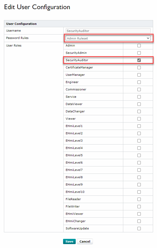

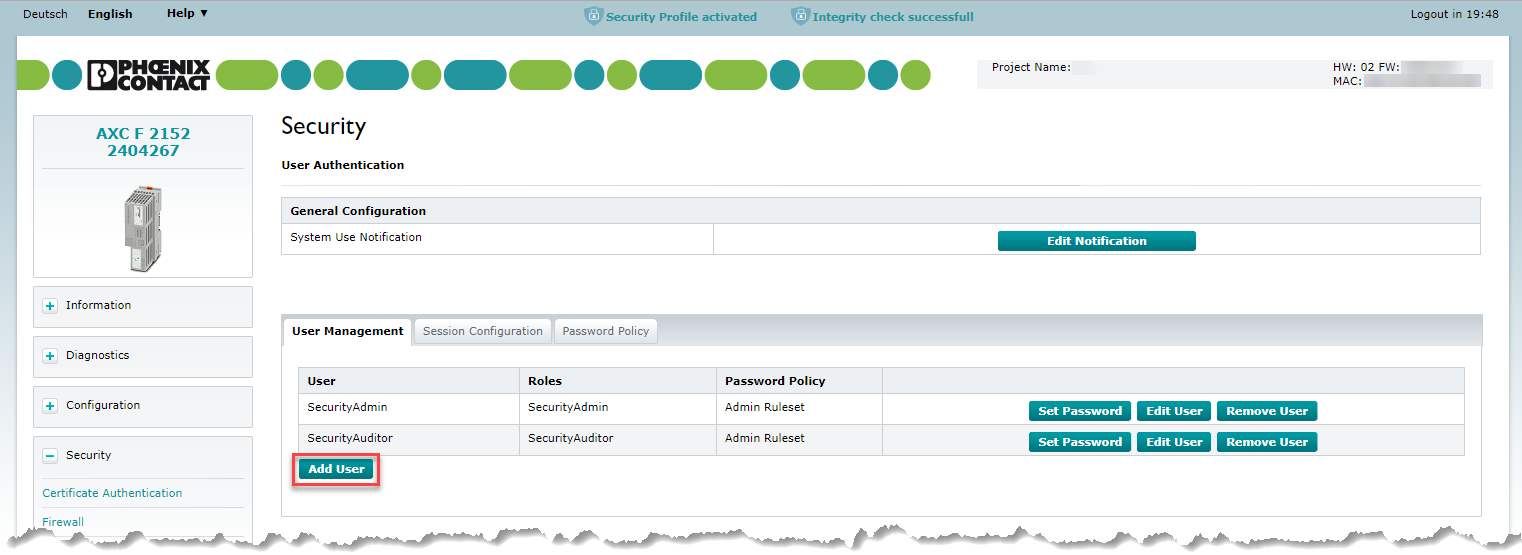

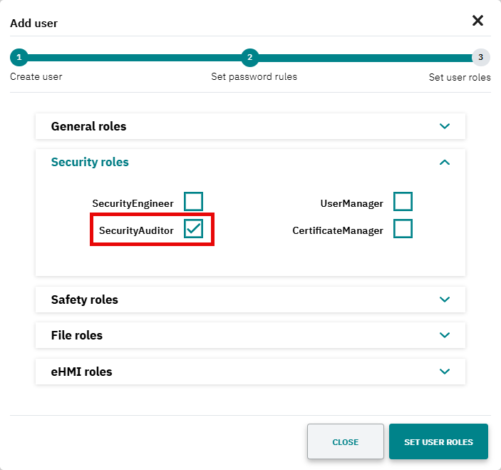

Adding a Security Auditor
To add a Security Auditor, proceed as follows:
  • Open the Security → User management page in the WBM.
  • Enter a username and a password following the password complexity rules.
  • Select the Security role SecurityAuditor.
    ↪ You have added a Security Auditor.
  • When you log in as a Security Auditor, edit the user's initial password.

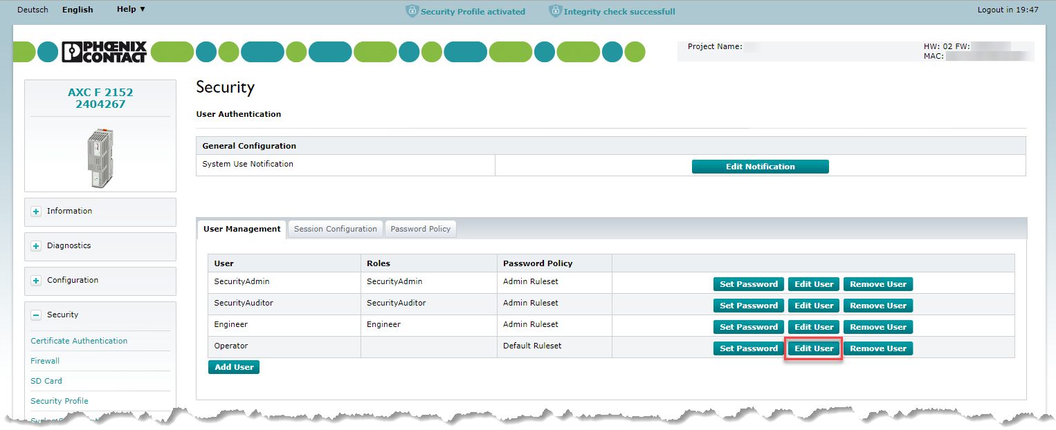

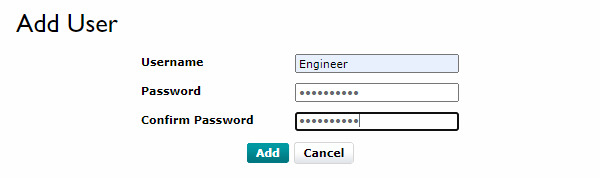

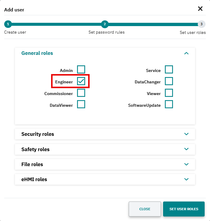

Adding an Engineer
To add an Engineer, proceed as follows:

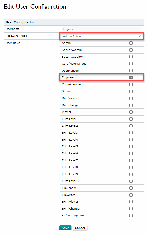

  • Select a password ruleset (the Default ruleset is recommended) and click the SET PASSWORD RULES button.

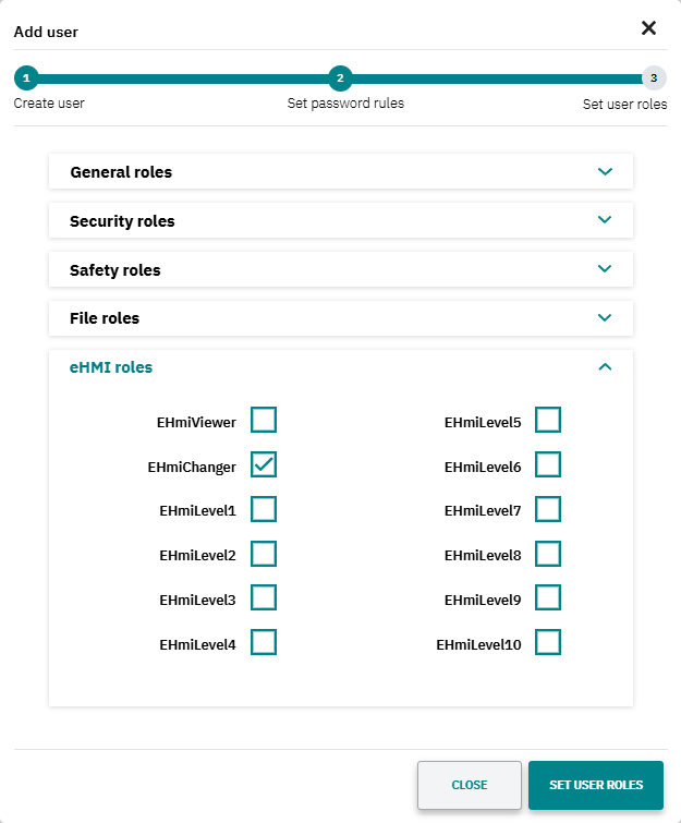

  • Select the General role Engineer.
  • Additionally, select the eHMI role EHmiChanger.
    Note: You need the EHmiChanger role to be able to test HMI applications that have been created. You must remove the EHmiChanger role from the engineer before commissioning the system!
    ↪ You have added an Engineer.
  • When you log in as Engineer, edit the user's initial password.

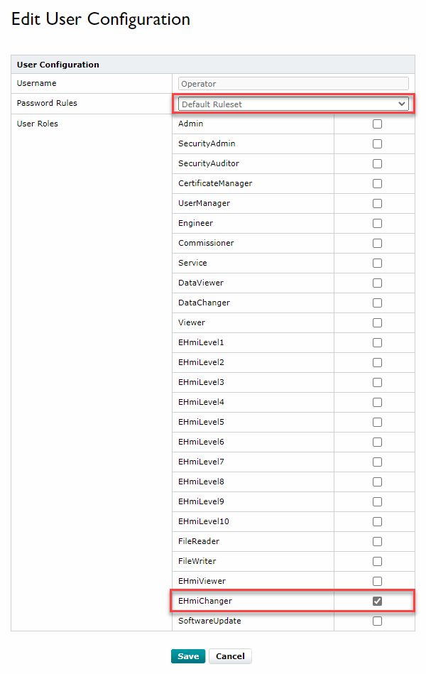

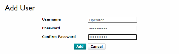

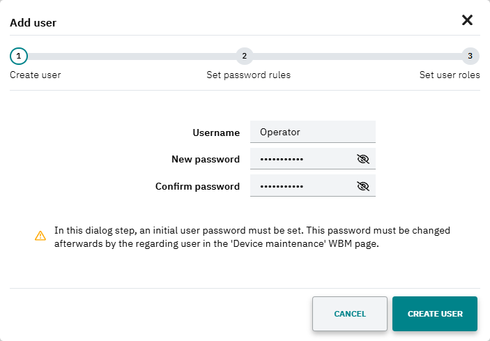

Adding an Operator
To add an Operator, proceed as follows:
  • Select the eHMI role EHmiChanger.
    ↪ You have added an Operator.
  • When you log in as Operator, edit the user's initial password.

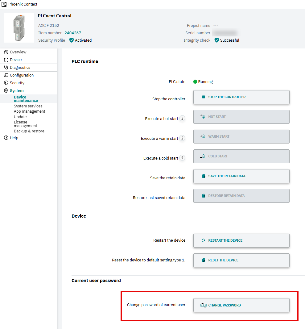

Changing the password
Note: Users must change their passwords following the password complexity rules when they log in with their role for the first time.
You can change the user password on the Device maintenance page (System → Device maintenance) in the WBM.

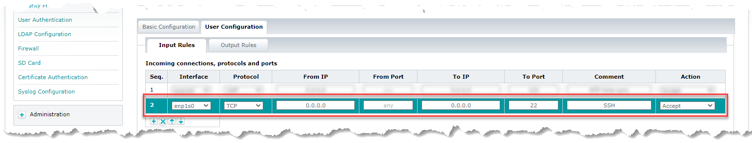

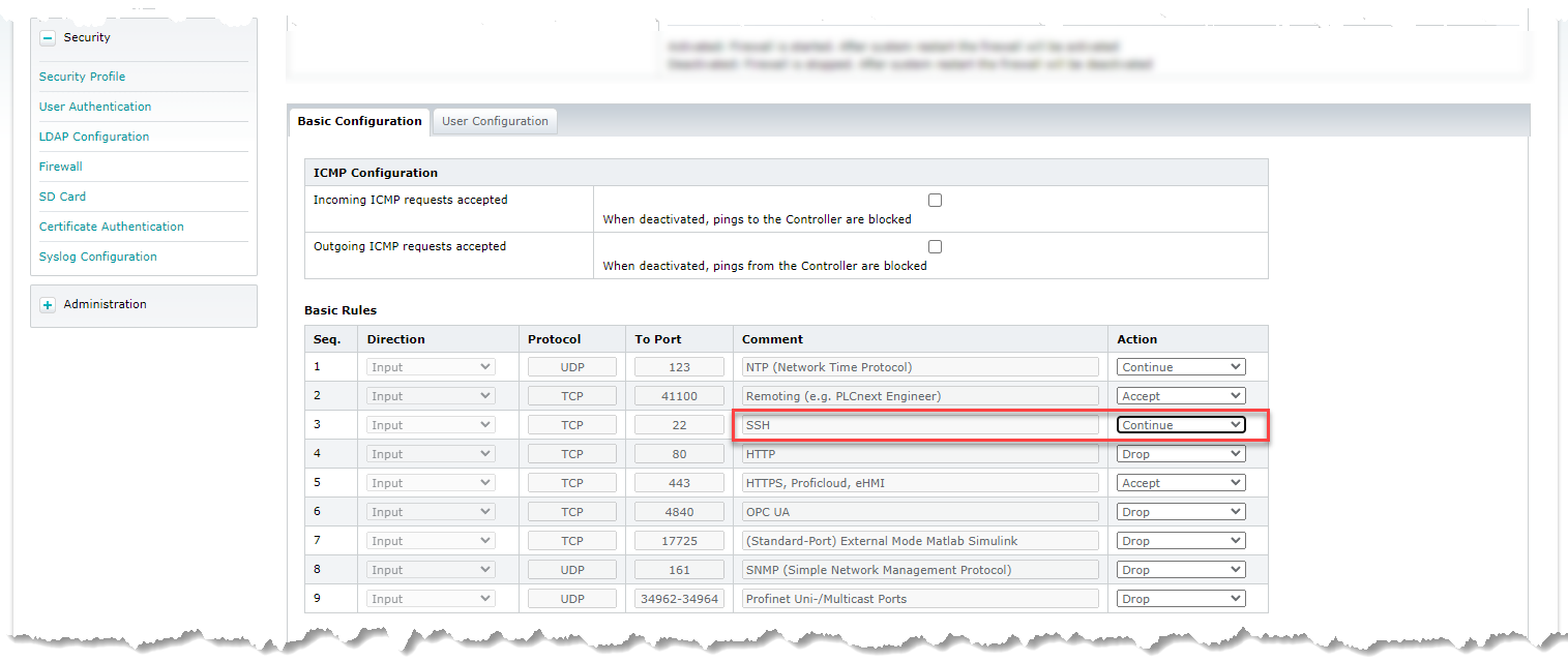

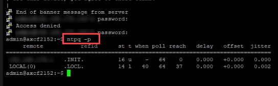

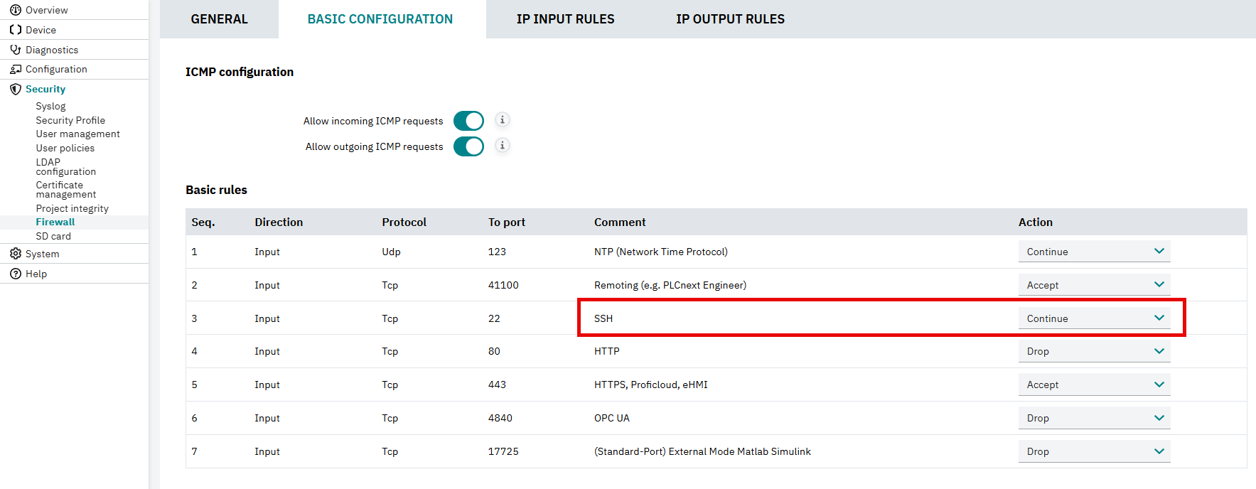

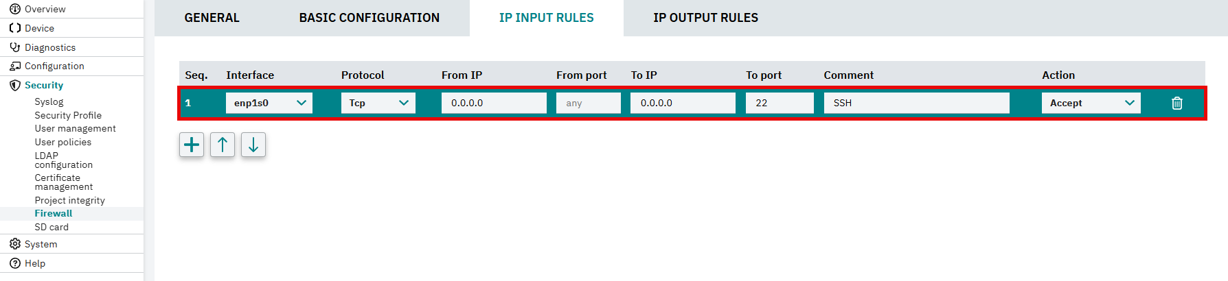

With the Admin user, you can also use SSH to check the NTP connection. To do this, you must enable SSH in the firewall basic configurations (for more information, refer to the firewall basic configurations) and set an input rule:
Basic Configuration:
Input Rule:
Note: Configure the IP addresses in the firewall so that SSH access can only take place from the defined device.
Using the console, you can now check whether the connection has been established by using the ntpq -p command.
