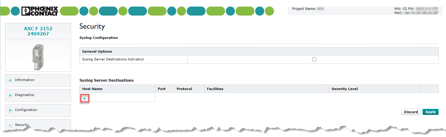

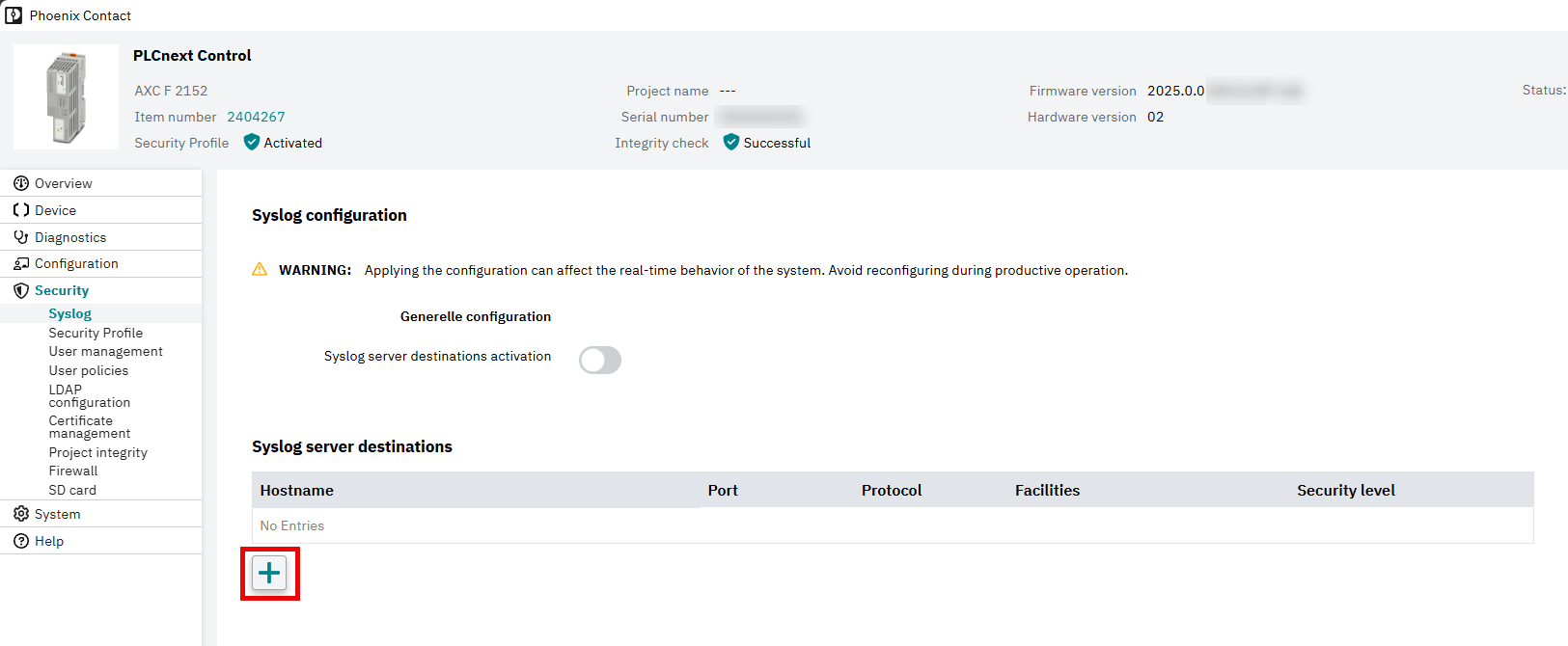

  • Open the Syslog configuration page (Security → Syslog).
  • To add a new Syslog server destination configuration, select the  button.

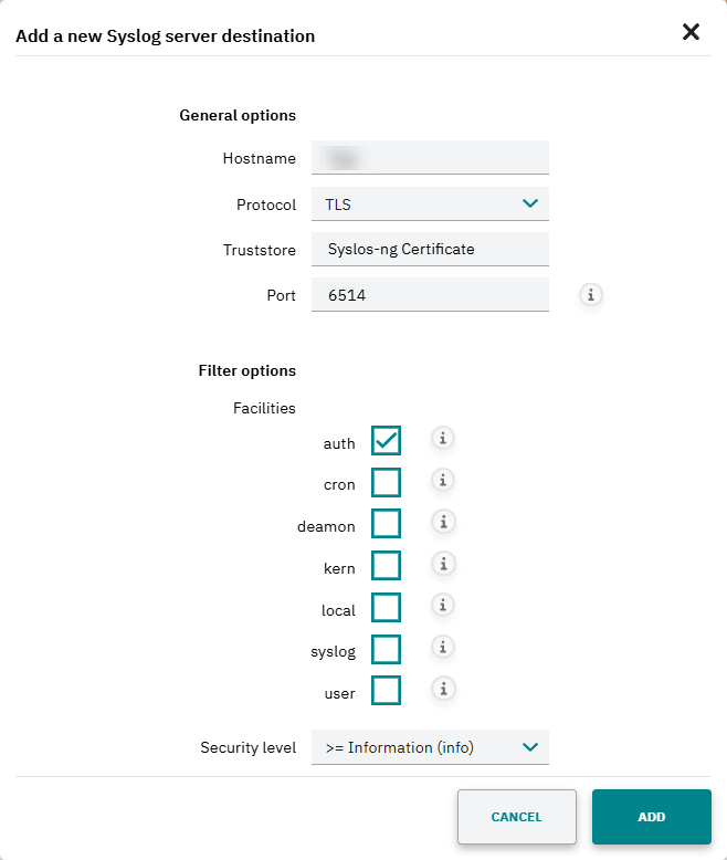

  • Provide the following information:
    • Hostname: IP address of the device (host) to send the logging messages to.
    • Protocol: It is recommended to configure TLS.
    • Truststore: Select the trust store.
    • Port: Select the port on which the devices exchange data. Make sure that the port is enabled in the firewall settings.
    • Facilities: Choose what kind of data should be exchanged. Choose auth in any case.
    • Severity Level: Select >=Information (info).
    • Click the ADD button.
