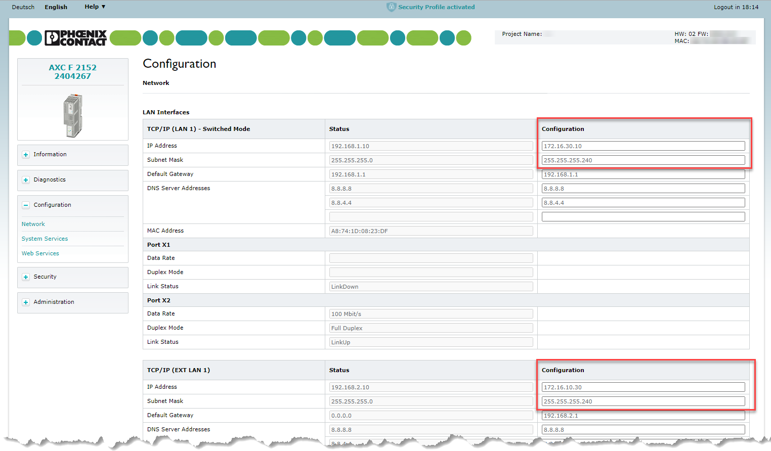

- Log in to the WBM.
- Open a web browser on your computer.
- In the address field, enter the URL https://<IP-address-of-the-controller>/wbm,

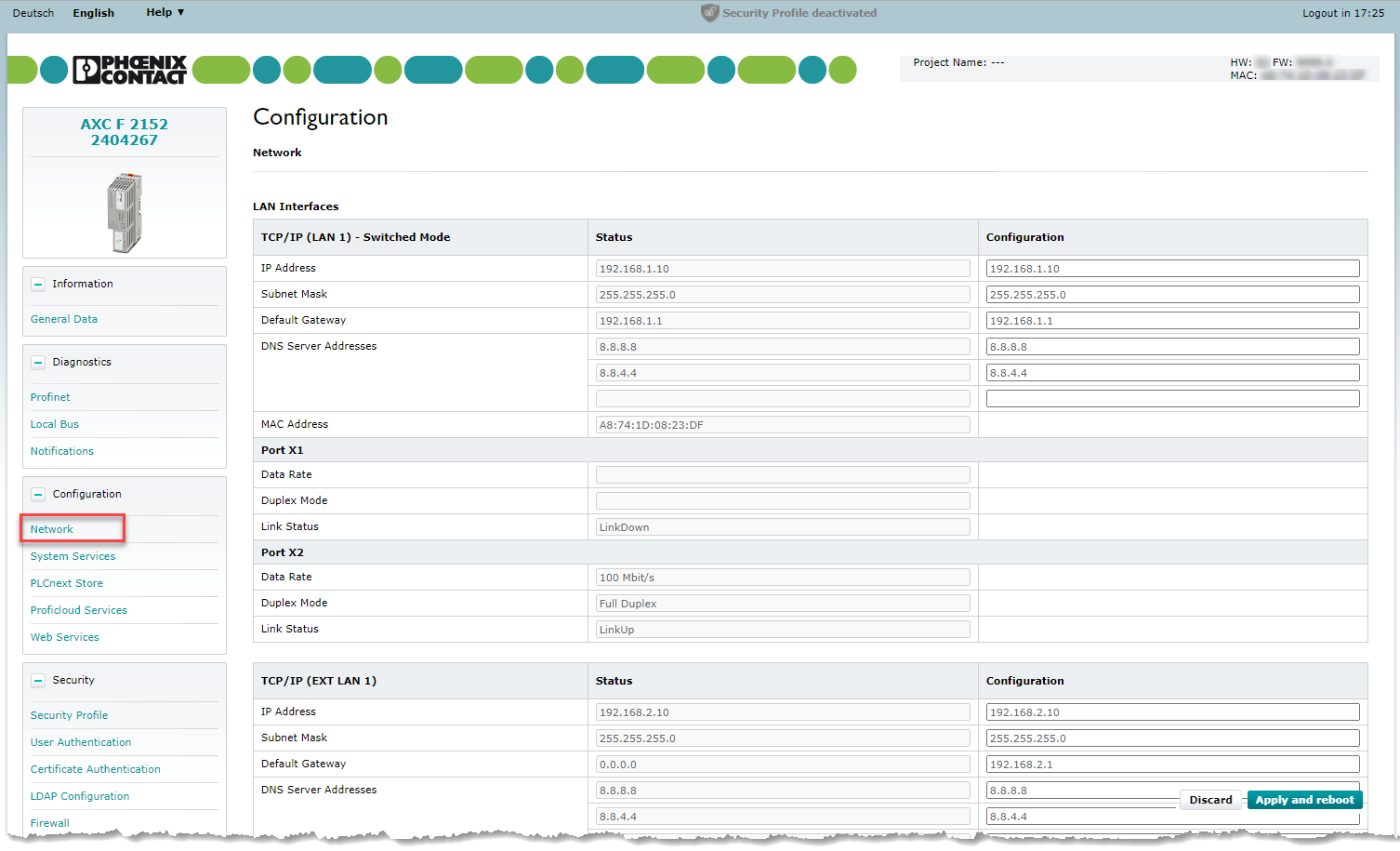

- Open the Network page (Configuration → Network).
The information under TCP/IP (LAN1) refers to the subordinate network, i.e. the extension module. The information under TCP/IP (EXT LAN 1) refers to the higher-level network, i.e. the PLCnext Control.
...continuation see next page...

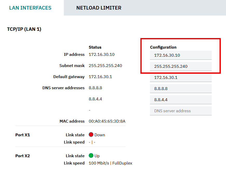

- Assign IP addresses and Subnet Masks for both networks appropriate for your security context (see topic Deriving IP addresses) by entering them in the Configuration area.
- Click the button.
