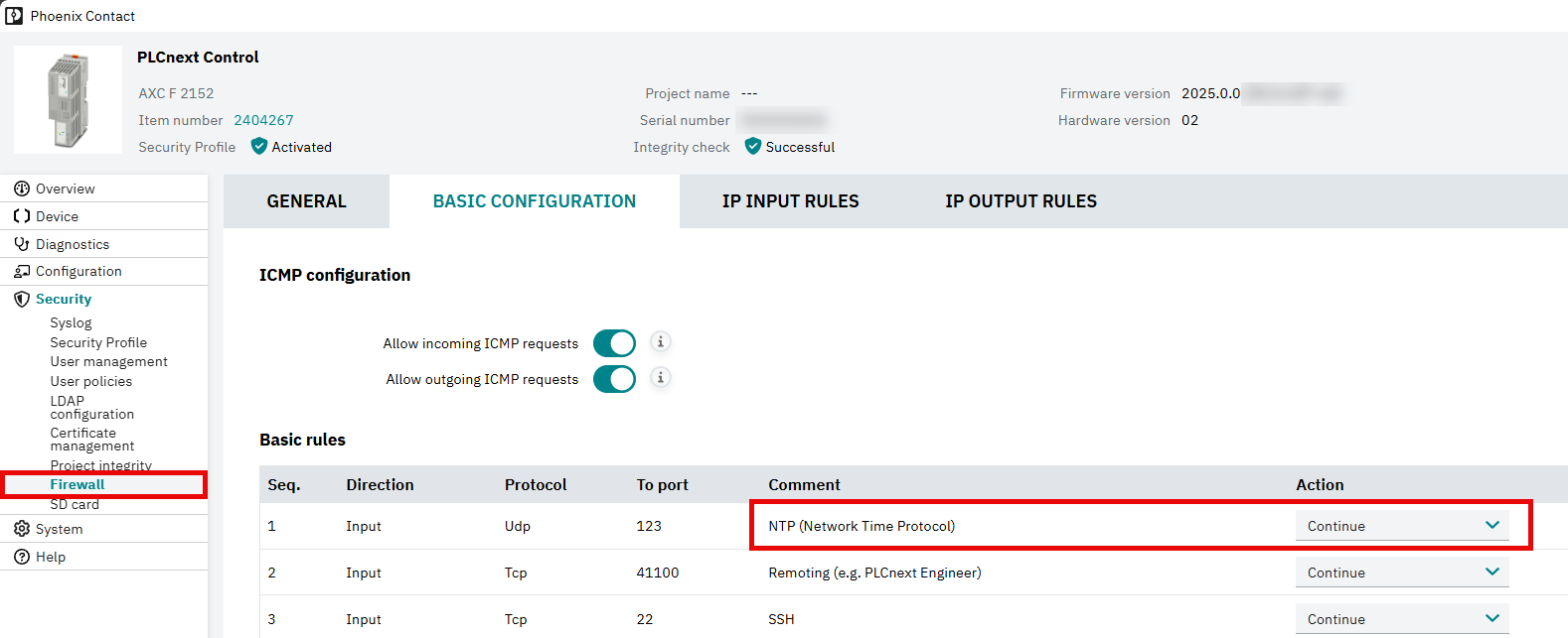

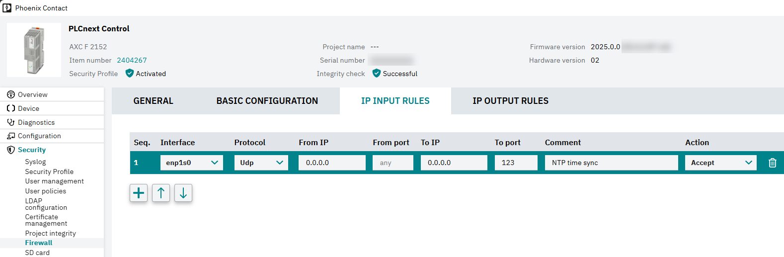

Note: Make sure that the firewall basic configurations and the input rules on the Firewall page (Security → Firewall) in the WBM are correct:
Basic Configuration:
Input Rules:
