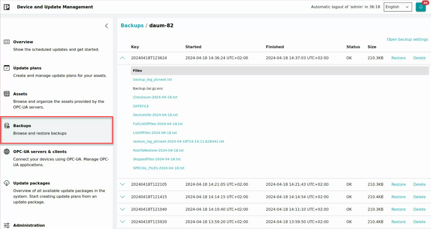

Backup and restore
To perform a backup and restore in this security context, use the DaUM Backup and Restore app. You can get the app via the PLCnext Storeand use it via the Device and Update Management.
  • You need admin rights to install and use the app.
  • To perform a backup, you must first create a new user named "DeviceBackup" with the following rights: FileReader, FileWriter, SoftwareUpdate.
    For more information on the different users, roles and rights, refer to the User Authentication topic in the main PLCnext Technology ‑ Info Center.
  • To perform a restore, you need admin rights.
  • Make sure the App Manager is activated.
  • Log in to the WBM.
  • Open the PLCnext Apps page (Administration → PLCnext Apps), install and start the app.
  • Open the Device and Update Management and proceed as described in the main PLCnext Technology - Info Center.
