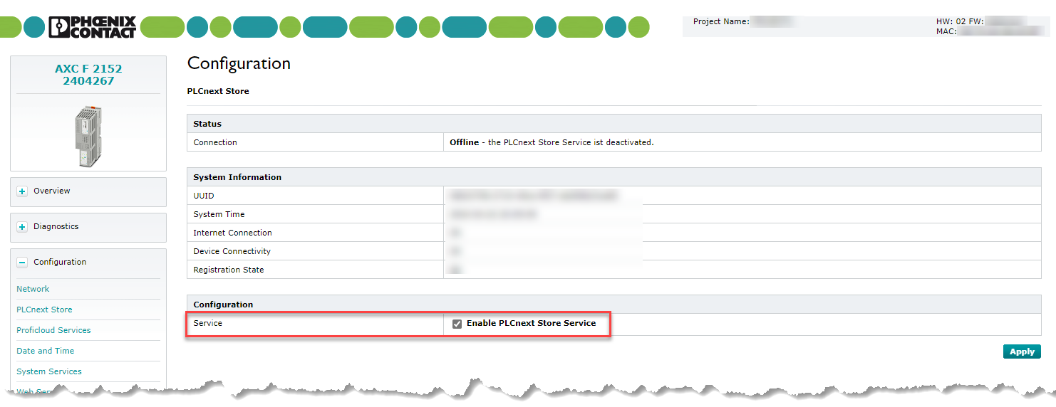

  • Activate the PLCnext Store Service in the WBM. To do this, proceed as follows (firmware 2021.0 LTS or newer):
    • Log in to the WBM.
    • Open the PLCnext Store  page (ConfigurationPLCnext Store).
    • Enable the checkbox Enable PLCnext Store Service.
    • Click the Apply button.
      Enable PLCnext Store Service in the WBM (firmware 2021.0 or newer)

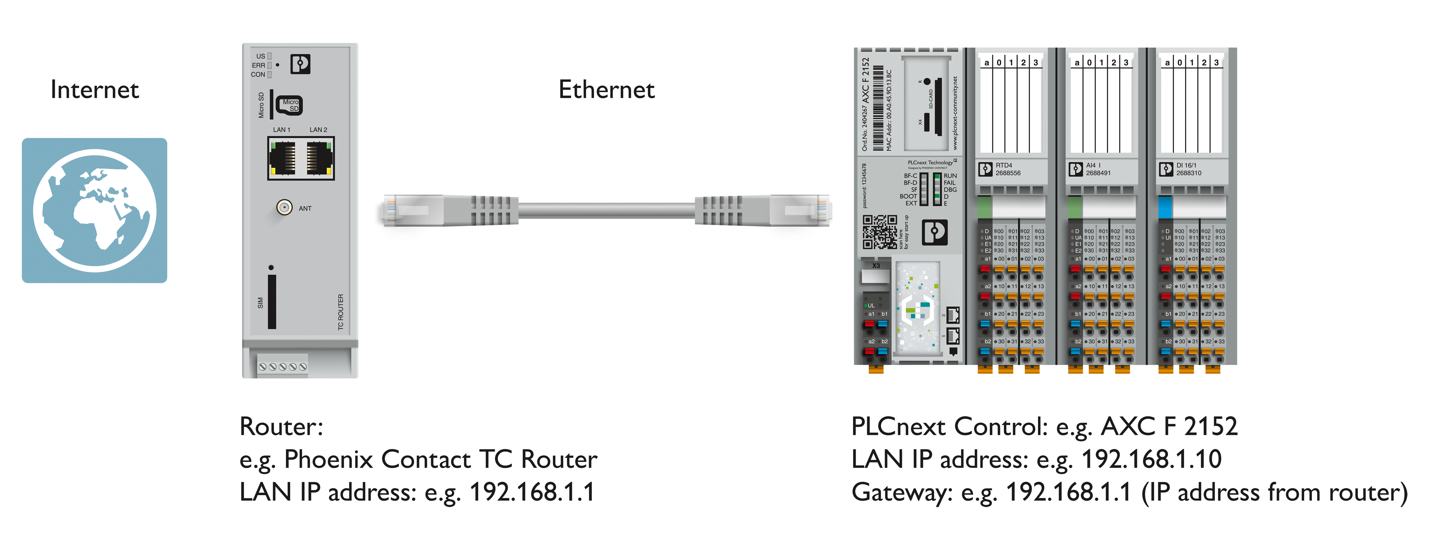

  • Assign an IP address, a subnet mask, and the corresponding gateway to your controller so that it can connect to the internet.
    • The IP address must be unique in your network.
    • The gateway is the IP address of your internet router.
     Information about configuring the IP settings can be found in the PLCnext Info Center

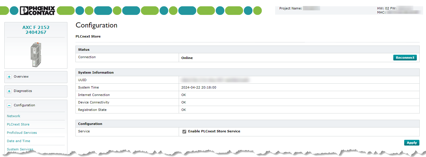

  • Check the connection statuses on the PLCnext Store page (ConfigurationPLCnext Store) in the WBM.
    If you have done everything correctly, the states should be as follows:
    Connection statuses in the WBM
