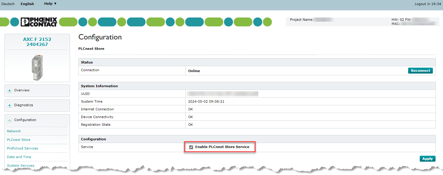

  • Open the WBM of your PLCnext Control with a browser (e.g.: https://192.168.1.10/wbm).
  • Open the PLCnext Store page (Configuration ­­ PLCnext Store) and make sure that the PLCnext Store Service is enabled.
  • Click the Apply button.

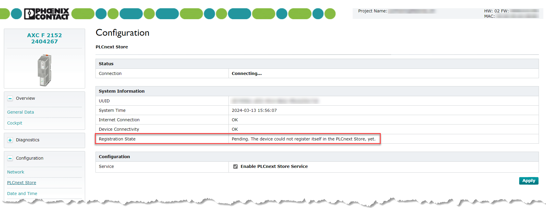

Still not working? After a reset, the communication of your PLCnext Control is blocked. In this case, the registration state in the WBM on the PLCnext Store page says Pending. The device could not register itself in the PLCnext Store, yet

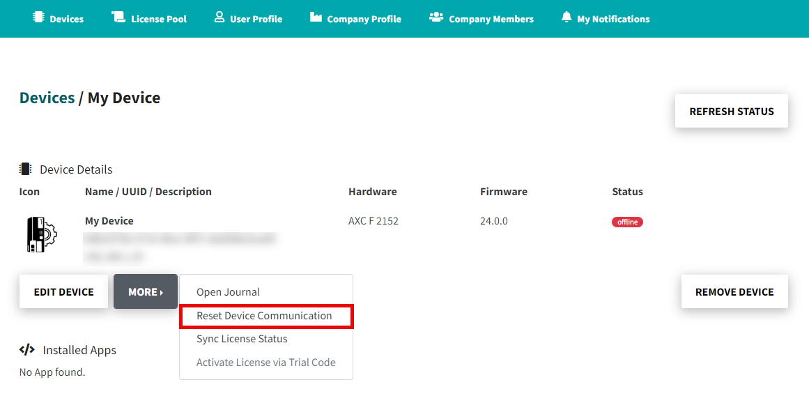

Proceed as follows to reactivate the communication:
  • Log in to the PLCnext Store, using your PLCnext Store account credentials.
  • Open your device list.
  • Select the device you want to put online.
  • Click the More button.
  • Chose Reset Device Communication.
This will automatically create a new security token for your device. This security token is automatically stored in the device and authenticates you as an authorized user.

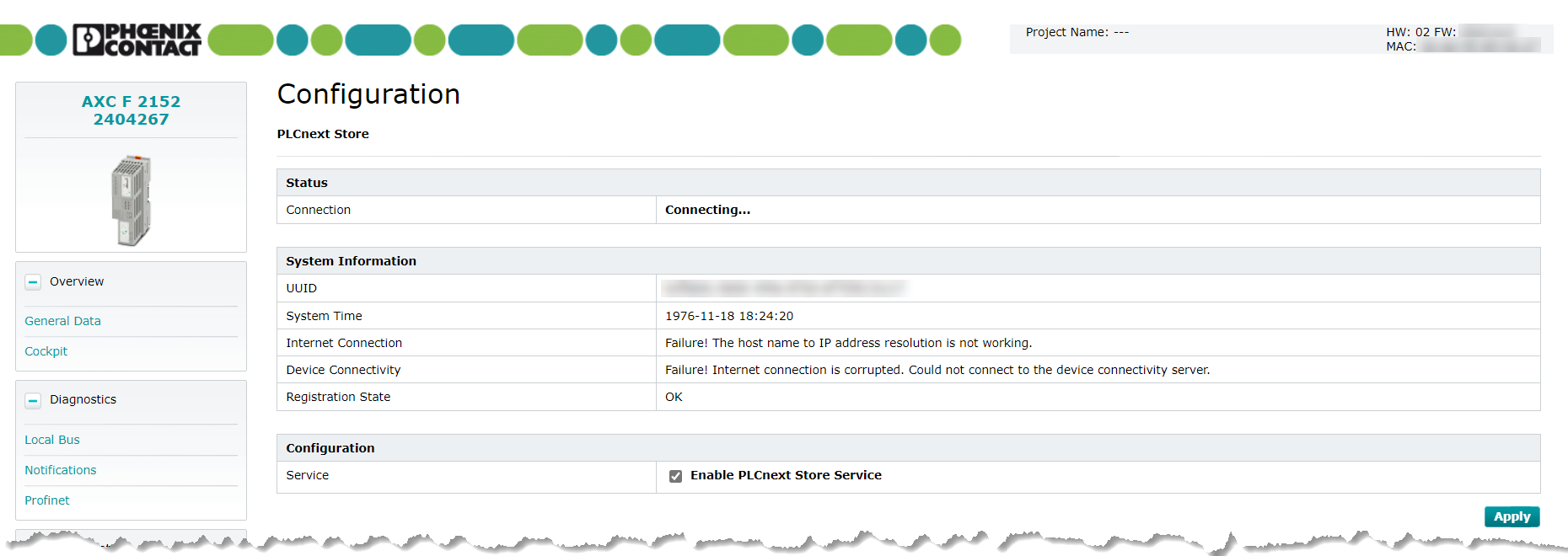

If your PLCnext Control has a connection problem, the PLCnext Store page shows corresponding information:
IP address and gateway
  • Check if the device IP address is unique and in the same IP address range as the gateway (internet router).
You can set the IP addresses via the WBM or via PLCnext Engineer
 For more information on how to configure the IP address, refer to the topic Configuration - Network in the PLCnext Technology Info Center.
System time
If the system time of the PLCnext Control is invalid, the security certificates are also invalid.
  • Check and set the system time of your PLCnext Control via PLCnext Engineer
 For more information on how to set the system time, refer to the topic System time in the PLCnext Technology Info Center.

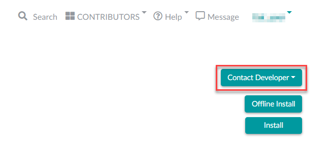

Apps are supported by the app provider themselves. The method of support must be discussed directly with the app provider.
  • To contact the app provider, press the Contact Developer button on the detail page of the app.

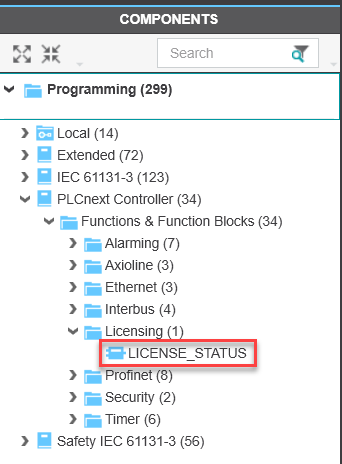

How you integrate our licensing mechanism in your app depends on the software type from your app. Solutions and Libraries (IEC-61131) must include a license function block in the PLCnext Engineer project.
Wibu mechanisms are used to check the license.
In case your app is programmed in C++ you use the method GetLicenseStatus which is offered in the SDK 2019.6.
